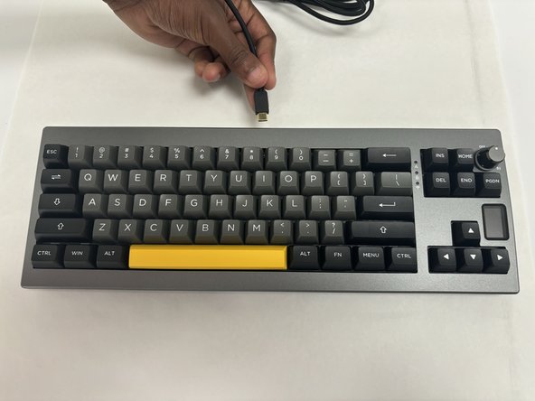

    • Power off the Epomaker Shadow-X keyboard.
    • Disconnect any attached cables.

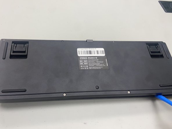

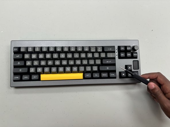

    • Use a hex screwdriver to remove all eight screws on the underside of the keyboard.
  3. Epomaker Shadow-X Battery Replacement: crwdns2935265:03crwdnd2935265:01crwdnd2935265:02crwdne2935265:0 Epomaker Shadow-X Battery Replacement: crwdns2935265:03crwdnd2935265:02crwdnd2935265:02crwdne2935265:0

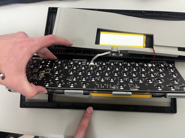

    • Use a plastic opening tool to gently pry open the keyboard case, working your way around each side.
    • Carefully separate the top and bottom covers, being mindful of any connecting cables between the two halves.

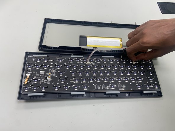

    • Use your fingernails to gently "walk" the battery connector directly out of its socket.
  5. Epomaker Shadow-X Battery Replacement: crwdns2935265:05crwdnd2935265:01crwdnd2935265:02crwdne2935265:0 Epomaker Shadow-X Battery Replacement: crwdns2935265:05crwdnd2935265:02crwdnd2935265:02crwdne2935265:0
    • Use an opening tool to gently pry the battery out of the chassis.
    • Take care not to bend or puncture the battery.
    • Press the battery into place using any adhesive or mounting tabs provided with the replacement.
