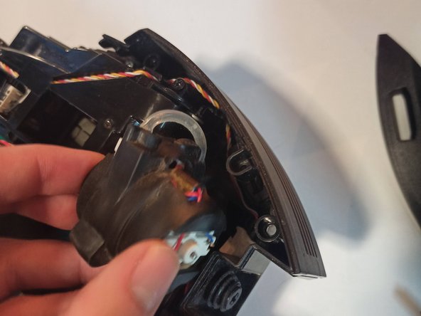

Ecovacs Deebot 920 Reassembly
  1. Ecovacs Deebot 920 Reassembly, Reinstall The Beater Bar Motor: crwdns2935265:01crwdnd2935265:01crwdnd2935265:01crwdne2935265:0
    • If removed, slide the wires for the beater bar motor through their access hole, and force the new grommet through the hole as well. Place the grommet into it's holder. Assembled photo for reference.
    • Screw the three beater motor screws into place to secure the motor to the housing.

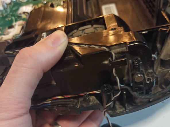

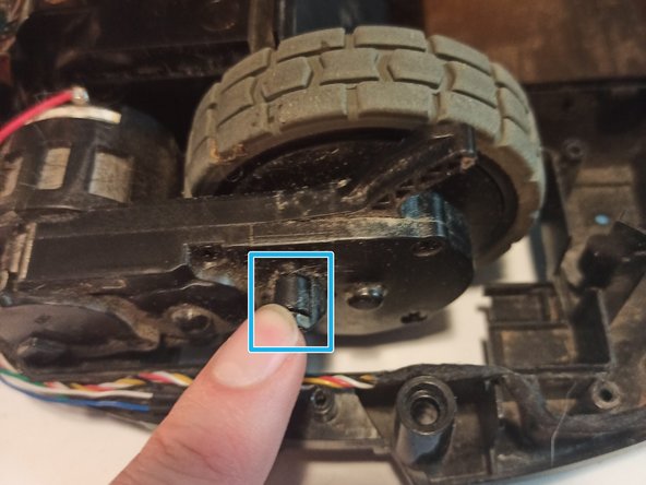

  4. Ecovacs Deebot 920 Reassembly, Concerning Wheel Wells: crwdns2935265:04crwdnd2935265:01crwdnd2935265:03crwdne2935265:0 Ecovacs Deebot 920 Reassembly, Concerning Wheel Wells: crwdns2935265:04crwdnd2935265:02crwdnd2935265:03crwdne2935265:0 Ecovacs Deebot 920 Reassembly, Concerning Wheel Wells: crwdns2935265:04crwdnd2935265:03crwdnd2935265:03crwdne2935265:0
    • Each wheel well has a traction spring which pushes down on a finger in the housing, keeping the wheels firmly on the ground.
    • The finger rides along a bushing on the side of the wheel.
    • The spring-loaded fingers must be pushed up into the housing all the way, and then the wheels inserted underneath them so that the spring rests on the bushing.
    • The leeway for keeping the wheel in the appropriate location while all of the screws are removed from the wheel well is very small, so compression must be applied constantly between the wheel and wheel well to prevent the spring from dislodging.
    • The wheel should be fighting you constantly. If it is not, restart by setting the spring back onto the bushing.

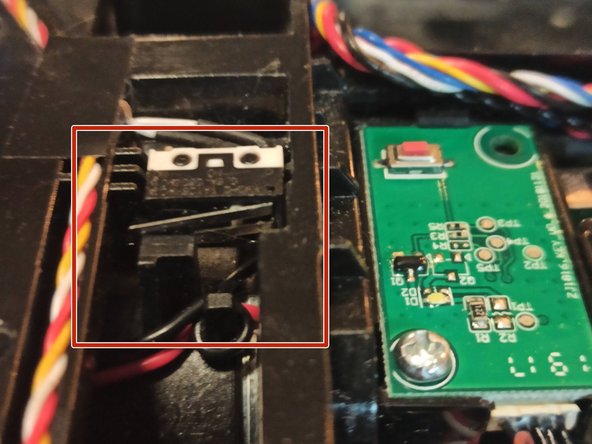

  5. Ecovacs Deebot 920 Reassembly, Concerning Wheel Wells (cont.): crwdns2935265:05crwdnd2935265:01crwdnd2935265:02crwdne2935265:0 Ecovacs Deebot 920 Reassembly, Concerning Wheel Wells (cont.): crwdns2935265:05crwdnd2935265:02crwdnd2935265:02crwdne2935265:0
    • When fully inserted and screwed down correctly, the reed switch (which indicates to the system that the wheel is off the floor) should be fully compressed, and the plastic finger which depresses it should be at or near the top of the silver portion of that switch.
    • An incorrectly installed wheel may not depress the switch completely, and may not reach the top of the silver area. The usual culprit is a pinched wire.

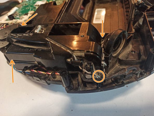

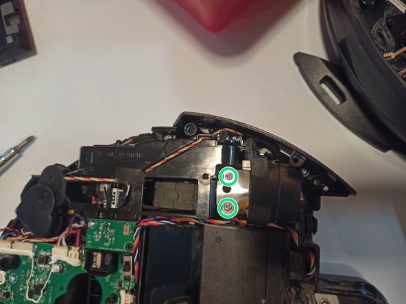

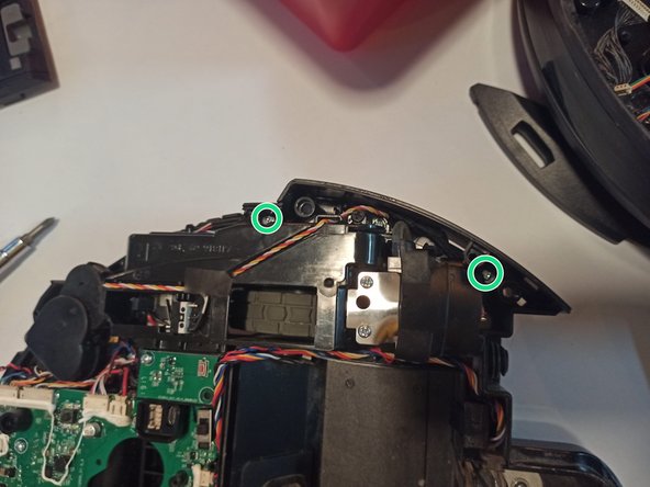

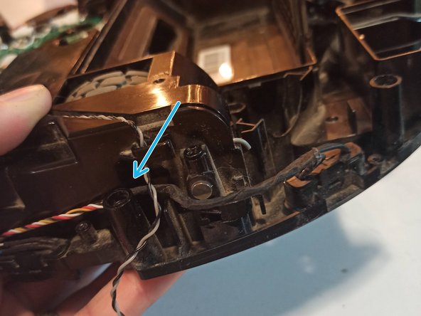

  6. Ecovacs Deebot 920 Reassembly, Install The Left Wheel Well: crwdns2935265:06crwdnd2935265:01crwdnd2935265:03crwdne2935265:0 Ecovacs Deebot 920 Reassembly, Install The Left Wheel Well: crwdns2935265:06crwdnd2935265:02crwdnd2935265:03crwdne2935265:0 Ecovacs Deebot 920 Reassembly, Install The Left Wheel Well: crwdns2935265:06crwdnd2935265:03crwdnd2935265:03crwdne2935265:0
    • Installing the wheel wells is the most time consuming portion of the task. Be sure to take your time, and be careful not to damage any wires.
    • Depress the spring to the left wheel well housing and push the wheel inside of it, keeping tension on the spring. Ensure that the spring rests on the wheel bushing.
    • The wheel wells are marked L and R on the front portion of the top of the housing.
    • Move the sensor wires running along the outside of the case up and over the screw peg temporarily.
    • Ensure that the rubber grommet which routes power to the wheel motors is positioned in its half-moon seat. This grommet is located towards the front center of the unit.
    • Seat the wheel well into position, and, while still applying pressure to the wheel, install two silver 10mm screws into opposing corners of the housing.
    • Ensure that no wires have become trapped.
    • Install the final two silver 10mm screws.

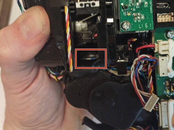

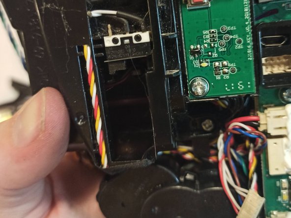

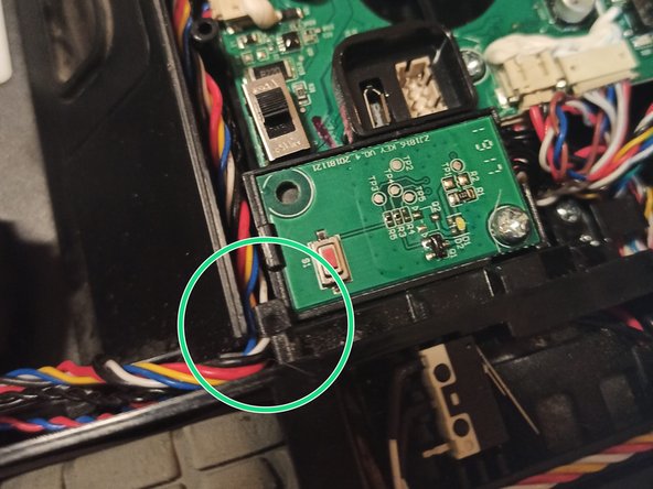

  7. Ecovacs Deebot 920 Reassembly, Install The Right Wheel Well: crwdns2935265:07crwdnd2935265:01crwdnd2935265:03crwdne2935265:0 Ecovacs Deebot 920 Reassembly, Install The Right Wheel Well: crwdns2935265:07crwdnd2935265:02crwdnd2935265:03crwdne2935265:0 Ecovacs Deebot 920 Reassembly, Install The Right Wheel Well: crwdns2935265:07crwdnd2935265:03crwdnd2935265:03crwdne2935265:0
    • Repeat the process on the other side of the vacuum.
    • Ensure that no wires have become trapped under the front of the housing. The area highlighted in red shows that the white/green/blue wire is pinched.
    • The next image shows that the pinch has been resolved, and a beautifully aligned reed switch.

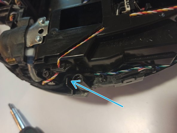

  8. Ecovacs Deebot 920 Reassembly, Installing The Right Wheel Well (cont.): crwdns2935265:08crwdnd2935265:01crwdnd2935265:03crwdne2935265:0 Ecovacs Deebot 920 Reassembly, Installing The Right Wheel Well (cont.): crwdns2935265:08crwdnd2935265:02crwdnd2935265:03crwdne2935265:0 Ecovacs Deebot 920 Reassembly, Installing The Right Wheel Well (cont.): crwdns2935265:08crwdnd2935265:03crwdnd2935265:03crwdne2935265:0
    • While installing the right wheel housing into the unit, ensure that each of the three wire bundles coming out of the top of the motherboard by the power switch are placed underneath this plastic tab. This tap keeps them from being pinched when the top cover is replaced.
    • If the vacuum suction motor or the water pump motors were removed before this step, ensure that their wires are inserted under this tab now, before finishing the wheel well installation.
    • Replace the sensor wires which were temporarily placed outside of the screw pegs.
    • Both of the wheel wells should be at the same height above the top of the dust bin area. If they are not equal, it is possible that one of the housings has a pinched wire, or was incorrectly stressed upon insertion, meaning that it did not fully seat down along the sides.
    • Give the sides of the wheel well a quick pinch to see if this correctly seats the wheel well. Snug up all screws again if you find success.

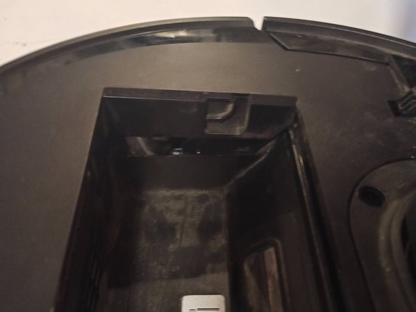

  10. Ecovacs Deebot 920 Reassembly, Install The Suction Motor: crwdns2935265:010crwdnd2935265:01crwdnd2935265:01crwdne2935265:0
    • Use two washer head screws to install the suction motor with a #1 Phillips bit.
    • Ensure that the rubber gasket for the motor screen is correctly seated into the bottom housing.
    • Ensure that the dust bin sensor switch is correctly seated.
    • Clean the motor with a soft cloth or compressed air to remove built-up dirt. "Before" picture for reference.

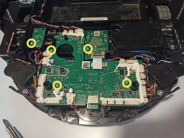

  12. Ecovacs Deebot 920 Reassembly, Install The Motherboard: crwdns2935265:012crwdnd2935265:01crwdnd2935265:02crwdne2935265:0 Ecovacs Deebot 920 Reassembly, Install The Motherboard: crwdns2935265:012crwdnd2935265:02crwdnd2935265:02crwdne2935265:0
    • Reconnect all wires to the motherboard, ensuring that any connectors underneath the board on the left side of this image (marked in orange) are also connected.
    • Install the motherboard and daughter boards with five silver 7mm screws.

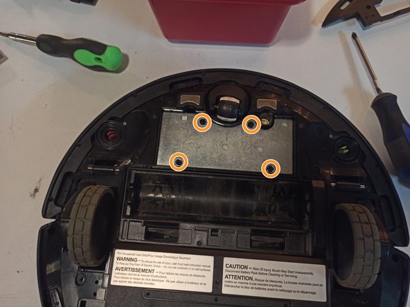

  19. Ecovacs Deebot 920 Reassembly, Install The Skid Plate: crwdns2935265:019crwdnd2935265:01crwdnd2935265:01crwdne2935265:0
    • Snap the skid plate into place.
    • Install eight black 7mm screws in the locations shown.

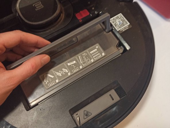

  20. Ecovacs Deebot 920 Reassembly, Install The Bins And Beater Bar: crwdns2935265:020crwdnd2935265:01crwdnd2935265:03crwdne2935265:0 Ecovacs Deebot 920 Reassembly, Install The Bins And Beater Bar: crwdns2935265:020crwdnd2935265:02crwdnd2935265:03crwdne2935265:0 Ecovacs Deebot 920 Reassembly, Install The Bins And Beater Bar: crwdns2935265:020crwdnd2935265:03crwdnd2935265:03crwdne2935265:0
    • Install the beater bar into its square drive hole, and install the cover plate. Install the color-coded side brushes.
    • Turn the unit right side up.
    • Install the dust bin and replace the cleaning brush, and install the water reservoir.
