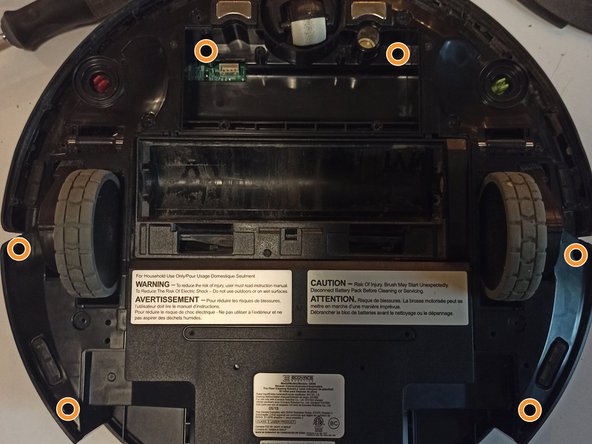

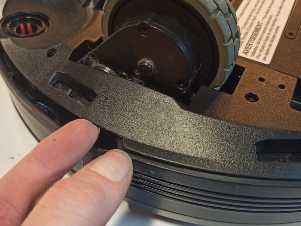

  3. Ecovacs Deebot 920 Disassembly, Remove The Skid Plate: crwdns2935265:03crwdnd2935265:01crwdnd2935265:03crwdne2935265:0 Ecovacs Deebot 920 Disassembly, Remove The Skid Plate: crwdns2935265:03crwdnd2935265:02crwdnd2935265:03crwdne2935265:0 Ecovacs Deebot 920 Disassembly, Remove The Skid Plate: crwdns2935265:03crwdnd2935265:03crwdnd2935265:03crwdne2935265:0
    • Remove the 8 black 7mm screws from the skid plate.
    • Lift up the skid plate from one of the corners by the water reservoir and remove.
    • If you have difficulty, you can also try to pry up the plate from the edge by the front bumper.

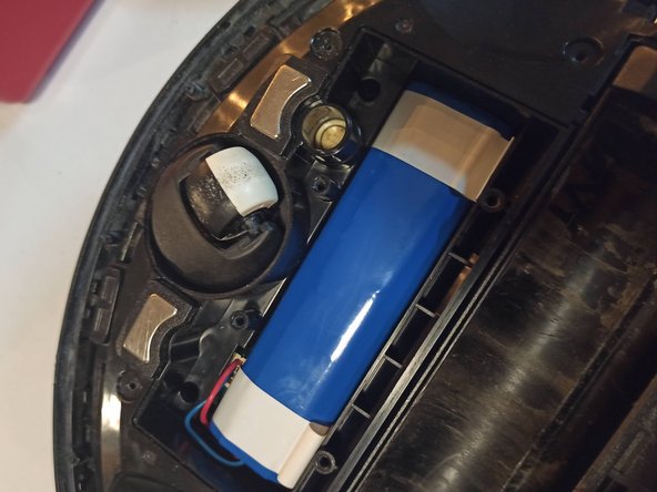

  4. Ecovacs Deebot 920 Disassembly, Remove The Battery: crwdns2935265:04crwdnd2935265:01crwdnd2935265:02crwdne2935265:0 Ecovacs Deebot 920 Disassembly, Remove The Battery: crwdns2935265:04crwdnd2935265:02crwdnd2935265:02crwdne2935265:0
    • Remove the 4 black 10mm screws from the weight.
    • Lift the white tabs on the battery to remove it, and unplug it from the motherboard.

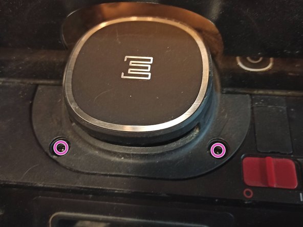

  6. Ecovacs Deebot 920 Disassembly, Remove Additional Screws: crwdns2935265:06crwdnd2935265:01crwdnd2935265:02crwdne2935265:0 Ecovacs Deebot 920 Disassembly, Remove Additional Screws: crwdns2935265:06crwdnd2935265:02crwdnd2935265:02crwdne2935265:0
    • Flip the unit back over. Use a small flathead screwdriver or spudger to remove the rubber covers near the laser sensor.
    • Remove the two washer head screws.

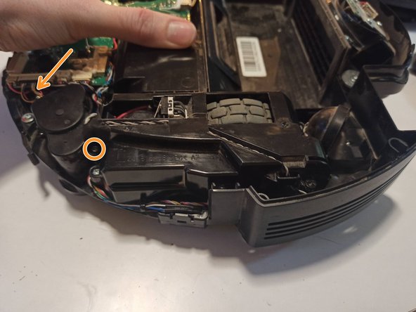

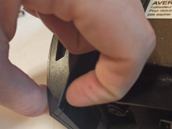

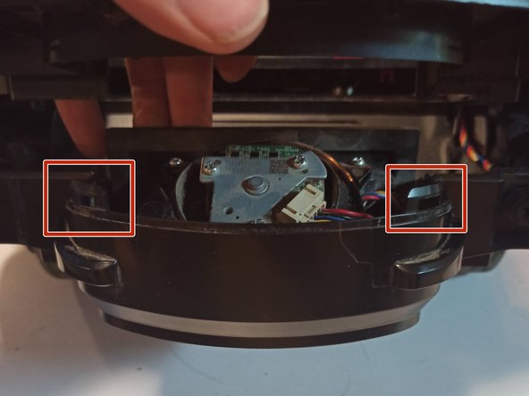

  7. Ecovacs Deebot 920 Disassembly, Lift The Top Cover: crwdns2935265:07crwdnd2935265:01crwdnd2935265:03crwdne2935265:0 Ecovacs Deebot 920 Disassembly, Lift The Top Cover: crwdns2935265:07crwdnd2935265:02crwdnd2935265:03crwdne2935265:0 Ecovacs Deebot 920 Disassembly, Lift The Top Cover: crwdns2935265:07crwdnd2935265:03crwdnd2935265:03crwdne2935265:0
    • There are 6 clips holding the top cover to the base.
    • Press in at the red arrow, by the water reservoir retention hook, to detach an internal retention clip.
    • The clips are outlined in red in the second image.
    • Pry up on the top cover at the orange arrow to begin unclipping the top of the unit.
    • Two additional clips are at the yellow arrow on either side of the unit. Pressing in at these locations aids in their removal.

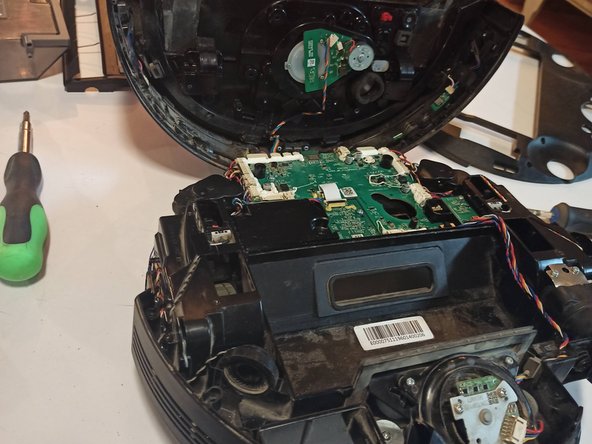

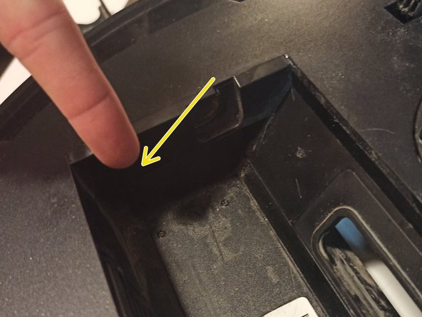

  8. Ecovacs Deebot 920 Disassembly, Finish Unclipping Top Cover: crwdns2935265:08crwdnd2935265:01crwdnd2935265:02crwdne2935265:0 Ecovacs Deebot 920 Disassembly, Finish Unclipping Top Cover: crwdns2935265:08crwdnd2935265:02crwdnd2935265:02crwdne2935265:0
    • The yellow rectangle indicates the location of the side clips in the dust bin area.
    • The final two clips are at the front of the case and should free themselves with a little lifting force and wiggling.
    • There are thin wires connecting sensors on the top of the unit to the motherboard. Do not lift the top up, rather, allow it to fold forward, and rest it against a wall or stack of books.

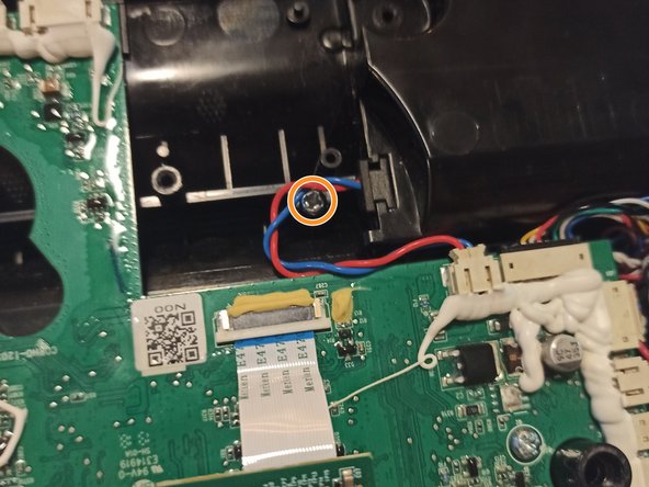

  11. Ecovacs Deebot 920 Disassembly, Unscrew And Unplug The Motherboard: crwdns2935265:011crwdnd2935265:01crwdnd2935265:03crwdne2935265:0 Ecovacs Deebot 920 Disassembly, Unscrew And Unplug The Motherboard: crwdns2935265:011crwdnd2935265:02crwdnd2935265:03crwdne2935265:0 Ecovacs Deebot 920 Disassembly, Unscrew And Unplug The Motherboard: crwdns2935265:011crwdnd2935265:03crwdnd2935265:03crwdne2935265:0
    • This step is required to replace the motherboard, side brushes, or beater bar motor. It can be skipped in most other repairs.
    • Remove the 5 silver 7mm screws retaining the motherboard and daughter boards.
    • Fold down the center daughter board and remove the hidden silver 10mm screw. This screw holds in the beater bar housing and can be skipped for other repairs.
    • Remove all of the cables connecting the motherboard to the rest of the unit.
    • There are some connectors underneath the left side of the board, marked in yellow.
    • Depending on your repair, you may not need to remove all or any connectors to access the necessary screws.

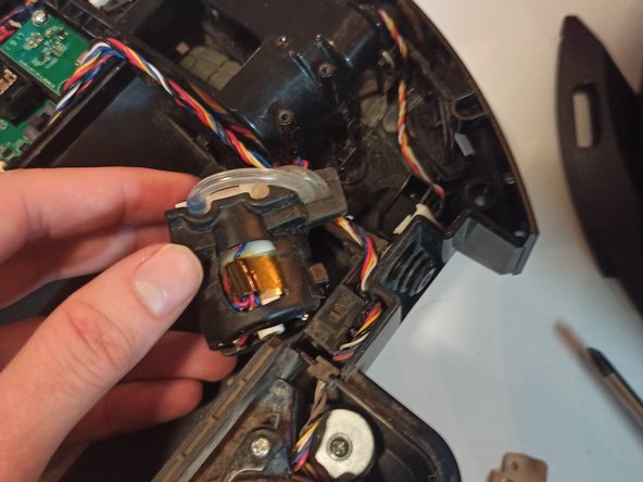

  12. Ecovacs Deebot 920 Disassembly, Remove The Water Pump: crwdns2935265:012crwdnd2935265:01crwdnd2935265:03crwdne2935265:0 Ecovacs Deebot 920 Disassembly, Remove The Water Pump: crwdns2935265:012crwdnd2935265:02crwdnd2935265:03crwdne2935265:0 Ecovacs Deebot 920 Disassembly, Remove The Water Pump: crwdns2935265:012crwdnd2935265:03crwdnd2935265:03crwdne2935265:0
    • This section is necessary to repair the water pump, right wheel motor, or beater bar. It can be skipped in most other repairs.
    • Remove the two silver 7mm screws from the side trim panel, and the two silver 7mm screws from the water pump retention clip.
    • Lift out the water pump, being aware of the water lines coming from the side and running underneath it, and place it into the dust bin area (if not replacing).
    • If replacing the water pump, remove the two water hoses from their barb connectors, unplug the motor from the motherboard, and remove.

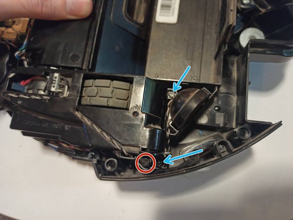

  14. Ecovacs Deebot 920 Disassembly, Remove the wheel wells and springs: crwdns2935265:014crwdnd2935265:01crwdnd2935265:02crwdne2935265:0 Ecovacs Deebot 920 Disassembly, Remove the wheel wells and springs: crwdns2935265:014crwdnd2935265:02crwdnd2935265:02crwdne2935265:0
    • This section is required to repair the wheel motors or beater bar motor. It can (and should) be skipped in most other repairs.
    • Remove the 4 silver 10mm screws on each wheel well.
    • Many wires are routed around the sides and top of these wheel wells. Take care not to pull or damage these wires when uninstalling the wheel wells.
    • The wheel wells have the traction springs inside of them, so you will hear a snap as you remove the final screws.
    • Do not errantly remove or adjust the black spring retention screw.

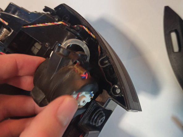

  15. Ecovacs Deebot 920 Disassembly, Remove The Beater Housing: crwdns2935265:015crwdnd2935265:01crwdnd2935265:01crwdne2935265:0
    • Almost all components, save the suction motor, must be loosened or removed to extract the housing.
    • The beater bar housing is held in by the hidden screw beneath the center daughterboard, as well as one screw from each of the wheel wells.
    • After removing surrounding components, lift up on the motor housing (outlined in blue) and allow it to hinge back towards the dust bin area, pivoting on the 135-degree area.
    • Once the housing for the two internal hinges for the beater bar are free, slide the beater bar housing up and out of the case towards the front.
    • The beater bar housing has a thin rubber dust funnel. Take care not to damage this rubber component.
