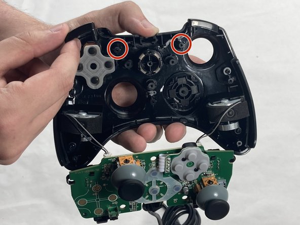

    • Use the iFixit opening tool to pry off the back cover and remove it to reveal the internal components.
    • Place the cover off to the side, then grab the circuit board and gently remove it from the front cover.
    • Be careful when removing the back cover, the components in this controller are loosely attached and can fall out easily.

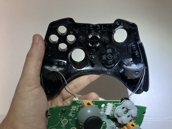

  3. EasySMX ESM-9100 Shoulder Buttons Replacement, L/R Buttons: crwdns2935265:03crwdnd2935265:01crwdnd2935265:03crwdne2935265:0 EasySMX ESM-9100 Shoulder Buttons Replacement, L/R Buttons: crwdns2935265:03crwdnd2935265:02crwdnd2935265:03crwdne2935265:0 EasySMX ESM-9100 Shoulder Buttons Replacement, L/R Buttons: crwdns2935265:03crwdnd2935265:03crwdnd2935265:03crwdne2935265:0
    • Remove the L and R shoulder buttons from their sockets on the top case.
    • Avoid touching the receiver as this is the component that will let the controller know the button has been pressed.
