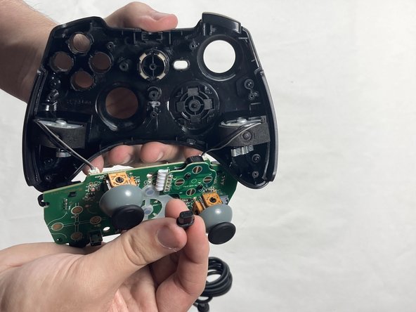

  3. EasySMX ESM-9100 Navigation Buttons Replacement, Navigation Buttons: crwdns2935265:03crwdnd2935265:01crwdnd2935265:02crwdne2935265:0 EasySMX ESM-9100 Navigation Buttons Replacement, Navigation Buttons: crwdns2935265:03crwdnd2935265:02crwdnd2935265:02crwdne2935265:0
    • Pull the back button out of the front cover.
    • Keep the controller face down while doing this to prevent the other buttons from falling out.

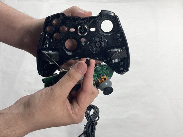

  4. EasySMX ESM-9100 Navigation Buttons Replacement: crwdns2935265:04crwdnd2935265:01crwdnd2935265:02crwdne2935265:0 EasySMX ESM-9100 Navigation Buttons Replacement: crwdns2935265:04crwdnd2935265:02crwdnd2935265:02crwdne2935265:0
    • Pull the start button out of the front cover.

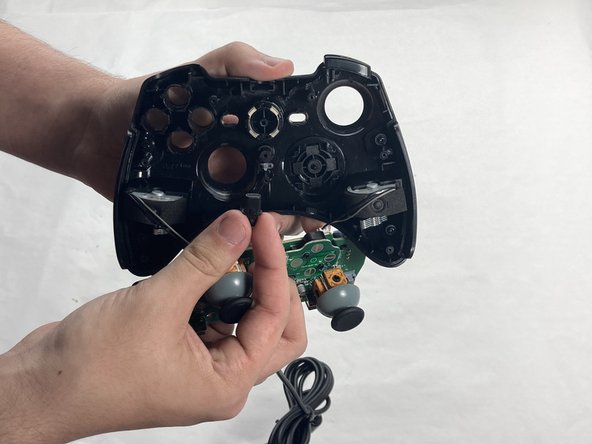

  5. EasySMX ESM-9100 Navigation Buttons Replacement: crwdns2935265:05crwdnd2935265:01crwdnd2935265:02crwdne2935265:0 EasySMX ESM-9100 Navigation Buttons Replacement: crwdns2935265:05crwdnd2935265:02crwdnd2935265:02crwdne2935265:0
    • Pull the turbo button out from the front cover carefully.
