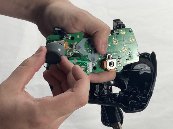

  3. EasySMX ESM-9100 Joystick Replacement, Joystick: crwdns2935265:03crwdnd2935265:01crwdnd2935265:02crwdne2935265:0 EasySMX ESM-9100 Joystick Replacement, Joystick: crwdns2935265:03crwdnd2935265:02crwdnd2935265:02crwdne2935265:0
    • Firmly pull off the two analog sticks (joysticks) from the potentiometers.
    • Be careful when removing the analog sticks as excessive force can cause damage to the potentiometer.
