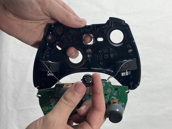

    • Use the iFixit opening tool to pry off the back cover and remove it to reveal the internal components.
    • Place the cover off to the side, then grab the circuit board and gently remove it from the front cover.
    • Be careful when removing the back cover, the components in this controller are loosely attached and can fall out easily.

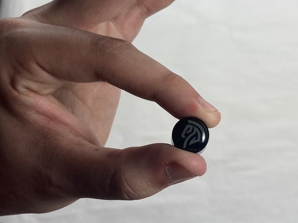

  3. EasySMX ESM-9100 Home Button Replacement, Home Button: crwdns2935265:03crwdnd2935265:01crwdnd2935265:03crwdne2935265:0 EasySMX ESM-9100 Home Button Replacement, Home Button: crwdns2935265:03crwdnd2935265:02crwdnd2935265:03crwdne2935265:0 EasySMX ESM-9100 Home Button Replacement, Home Button: crwdns2935265:03crwdnd2935265:03crwdnd2935265:03crwdne2935265:0
    • Press on the home button from the front of the top cover to pop it through.
    • Gently remove it from the backside of the top cover.
    • When replacing the home button make sure to align the tabs on the button with the grooves in the socket.
