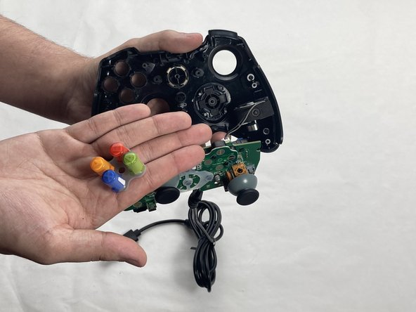

    • Place the controller face down on a solid surface.
    • Use a Phillips #00 screwdriver to remove the seven 10 mm screws from the back cover.
    • The order does not matter.
  2. EasySMX ESM-9100 Face Buttons Replacement: crwdns2935265:02crwdnd2935265:01crwdnd2935265:03crwdne2935265:0 EasySMX ESM-9100 Face Buttons Replacement: crwdns2935265:02crwdnd2935265:02crwdnd2935265:03crwdne2935265:0 EasySMX ESM-9100 Face Buttons Replacement: crwdns2935265:02crwdnd2935265:03crwdnd2935265:03crwdne2935265:0
    • Use the iFixit opening tool to pry off the back cover and remove it to reveal the internal components.
    • Place the cover off to the side, then grab the circuit board and gently remove it from the front cover.
    • Be careful when removing the back cover, the components in this controller are loosely attached and can fall out easily.

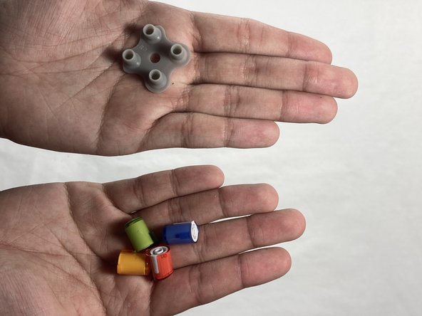

  3. EasySMX ESM-9100 Face Buttons Replacement, A/B/X/Y Buttons: crwdns2935265:03crwdnd2935265:01crwdnd2935265:02crwdne2935265:0 EasySMX ESM-9100 Face Buttons Replacement, A/B/X/Y Buttons: crwdns2935265:03crwdnd2935265:02crwdnd2935265:02crwdne2935265:0
    • Gently pull out the buttons by the rubber backing from the top cover.
    • Be gentle so the buttons don't fall off the rubber back as you pull it out.
  4. EasySMX ESM-9100 Face Buttons Replacement: crwdns2935265:04crwdnd2935265:01crwdnd2935265:02crwdne2935265:0 EasySMX ESM-9100 Face Buttons Replacement: crwdns2935265:04crwdnd2935265:02crwdnd2935265:02crwdne2935265:0
    • Gently pull each face button off of the rubber backing.
    • The buttons should be on the rubber in order of Y at the top, B to the right, A at the bottom, and X to the left.
