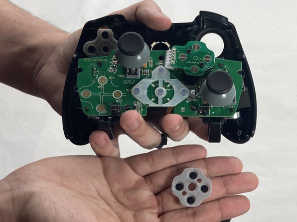

  3. EasySMX ESM-9100 D-Pad Replacement, D-Pad: crwdns2935265:03crwdnd2935265:01crwdnd2935265:02crwdne2935265:0 EasySMX ESM-9100 D-Pad Replacement, D-Pad: crwdns2935265:03crwdnd2935265:02crwdnd2935265:02crwdne2935265:0
    • Gently remove the rubber off the circuit board that corresponds with the d-pad.
    • Be careful to not damage the rubber which has two excess pieces that hang off of it and slot into the circuit board.
  4. EasySMX ESM-9100 D-Pad Replacement: crwdns2935265:04crwdnd2935265:01crwdnd2935265:01crwdne2935265:0
    • Gently push the d-pad back into the socket by pressing on it lightly.
    • The d-pad fits securely in the cover and cannot be removed without breaking the cover. Do not use excessive force when pushing it into place, as you may break the top cover.
