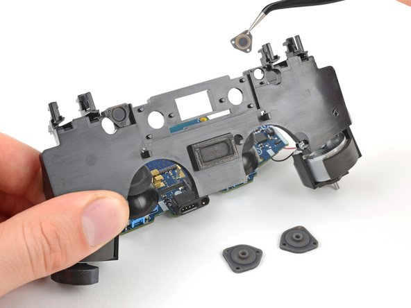

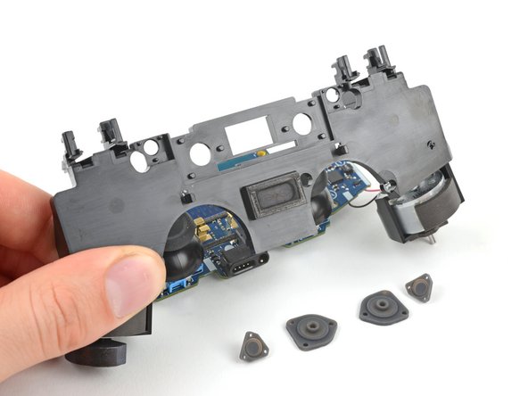

  21. DualShock 4 Touch Pad, Start, and Options Button Pads Replacement, Remove the button pads: crwdns2935265:021crwdnd2935265:01crwdnd2935265:03crwdne2935265:0 DualShock 4 Touch Pad, Start, and Options Button Pads Replacement, Remove the button pads: crwdns2935265:021crwdnd2935265:02crwdnd2935265:03crwdne2935265:0 DualShock 4 Touch Pad, Start, and Options Button Pads Replacement, Remove the button pads: crwdns2935265:021crwdnd2935265:03crwdnd2935265:03crwdne2935265:0
    • This step is pictured with the button circuit membrane removed. Although not strictly necessary for this repair, removing it may prevent accidental damage. To remove the membrane, follow this guide.
    • Remove the four button pads from the midframe:
    • Two pads for the touch pad
    • Two pads for the Start and Options buttons
