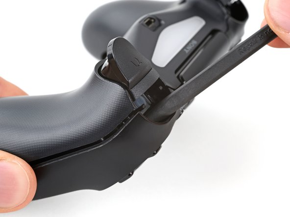

    • Six plastic clips secure the rear case to the front case. The next four steps demonstrate how to release these clips before you can open the controller.
    • Insert your opening pick at a downward angle between the front case and rear case, halfway between the handle and the action buttons.
    • Slide your pick toward the handle and pry up to release the first clip.
    • Repeat this procedure on the other side of the controller to release the second clip.

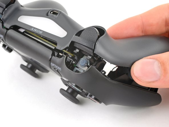

  9. DualShock 4 (CUH-ZCT1U) Speaker Replacement, Remove the rear case: crwdns2935265:09crwdnd2935265:01crwdnd2935265:03crwdne2935265:0 DualShock 4 (CUH-ZCT1U) Speaker Replacement, Remove the rear case: crwdns2935265:09crwdnd2935265:02crwdnd2935265:03crwdne2935265:0 DualShock 4 (CUH-ZCT1U) Speaker Replacement, Remove the rear case: crwdns2935265:09crwdnd2935265:03crwdnd2935265:03crwdne2935265:0
    • Press the R2 button and slide the rear case over it.
  10. DualShock 4 (CUH-ZCT1U) Speaker Replacement: crwdns2935265:010crwdnd2935265:01crwdnd2935265:01crwdne2935265:0
    • Press the L2 button and slide the rear case over it.
  11. DualShock 4 (CUH-ZCT1U) Speaker Replacement: crwdns2935265:011crwdnd2935265:01crwdnd2935265:03crwdne2935265:0 DualShock 4 (CUH-ZCT1U) Speaker Replacement: crwdns2935265:011crwdnd2935265:02crwdnd2935265:03crwdne2935265:0 DualShock 4 (CUH-ZCT1U) Speaker Replacement: crwdns2935265:011crwdnd2935265:03crwdnd2935265:03crwdne2935265:0
    • Flip the rear case over the top of the controller and lay it down, being careful not to strain the interconnect cable.

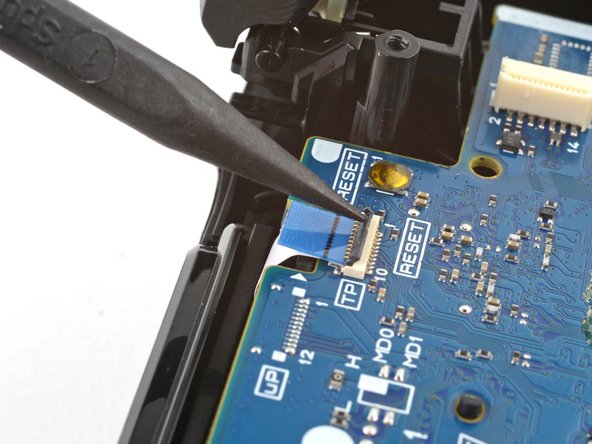

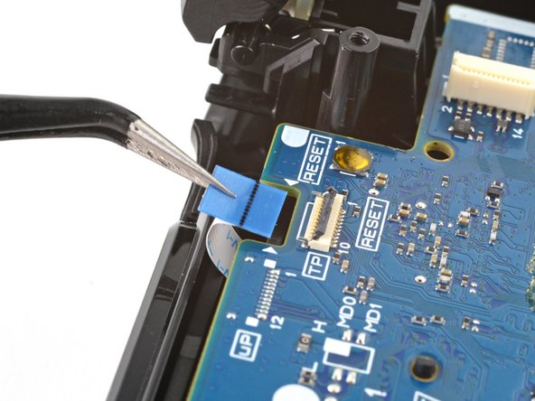

  18. DualShock 4 (CUH-ZCT1U) Speaker Replacement, Disconnect the touch pad: crwdns2935265:018crwdnd2935265:01crwdnd2935265:03crwdne2935265:0 DualShock 4 (CUH-ZCT1U) Speaker Replacement, Disconnect the touch pad: crwdns2935265:018crwdnd2935265:02crwdnd2935265:03crwdne2935265:0 DualShock 4 (CUH-ZCT1U) Speaker Replacement, Disconnect the touch pad: crwdns2935265:018crwdnd2935265:03crwdnd2935265:03crwdne2935265:0
    • Use the point of your spudger to flip up the locking flap securing the touch pad cable ZIF connector.
    • Use tweezers or your fingers to disconnect the cable using its blue pull tab.

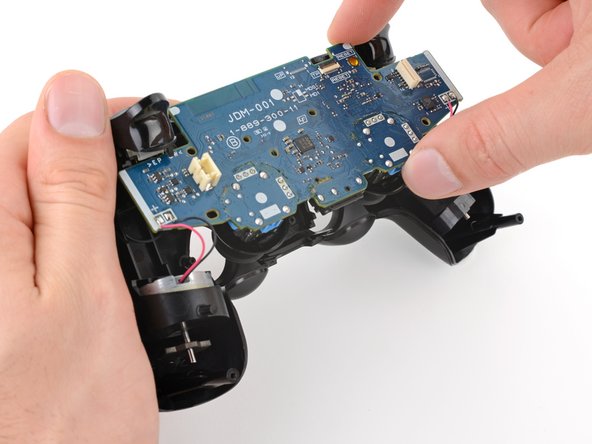

    • Use your Phillips screwdriver to remove the 6.4 mm screw securing the motherboard.
  20. DualShock 4 (CUH-ZCT1U) Speaker Replacement, Remove the motherboard: crwdns2935265:020crwdnd2935265:01crwdnd2935265:03crwdne2935265:0 DualShock 4 (CUH-ZCT1U) Speaker Replacement, Remove the motherboard: crwdns2935265:020crwdnd2935265:02crwdnd2935265:03crwdne2935265:0 DualShock 4 (CUH-ZCT1U) Speaker Replacement, Remove the motherboard: crwdns2935265:020crwdnd2935265:03crwdnd2935265:03crwdne2935265:0
    • Be careful not to strain the vibration motor cables. Follow this guide to re-solder the vibration motors if they break off the motherboard.
    • Lift the motherboard from the midframe.
    • Guide the analog stick covers through their cutouts in the front case.
    • Flip the motherboard over the bottom of the controller, leaving the vibration motor cables attached.
  21. DualShock 4 (CUH-ZCT1U) Speaker Replacement, Peel up the sticker: crwdns2935265:021crwdnd2935265:01crwdnd2935265:02crwdne2935265:0 DualShock 4 (CUH-ZCT1U) Speaker Replacement, Peel up the sticker: crwdns2935265:021crwdnd2935265:02crwdnd2935265:02crwdne2935265:0

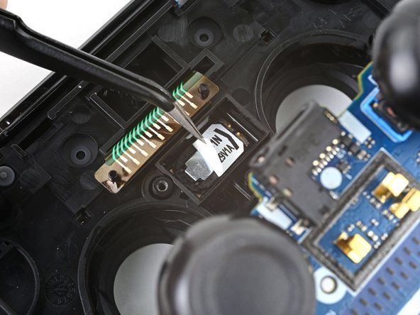

    • Use tweezers or your finger to peel up the left half of the speaker's sticker.

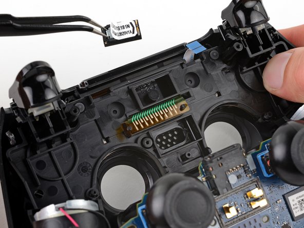

  22. DualShock 4 (CUH-ZCT1U) Speaker Replacement, Remove the speaker: crwdns2935265:022crwdnd2935265:01crwdnd2935265:03crwdne2935265:0 DualShock 4 (CUH-ZCT1U) Speaker Replacement, Remove the speaker: crwdns2935265:022crwdnd2935265:02crwdnd2935265:03crwdne2935265:0 DualShock 4 (CUH-ZCT1U) Speaker Replacement, Remove the speaker: crwdns2935265:022crwdnd2935265:03crwdnd2935265:03crwdne2935265:0
    • Insert your tweezers into the gaps in the corners of the speaker's metal backing.
    • Pry up to loosen the speaker from the front case.
    • The speaker is adhered to the front case.
    • Remove the speaker.
