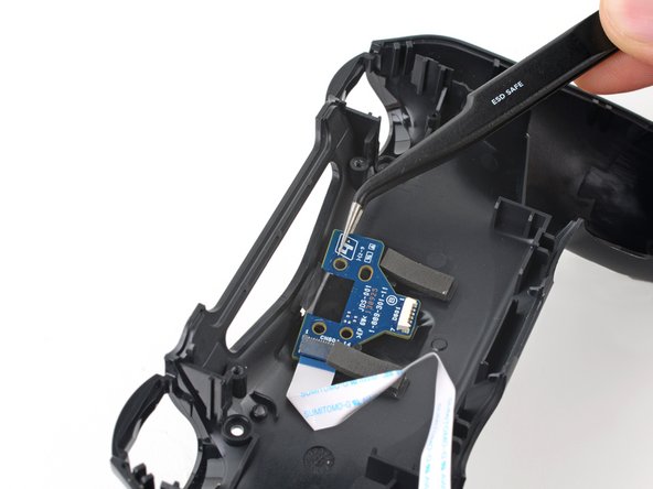

  18. DualShock 4 (CUH-ZCT1U) Rear Case Replacement, Unfasten the charging assembly: crwdns2935265:018crwdnd2935265:01crwdnd2935265:01crwdne2935265:0
    • Use your Phillips screwdriver to remove the two 4.6 mm screws securing the charging assembly to the rear case.
  19. DualShock 4 (CUH-ZCT1U) Rear Case Replacement, Remove the charging assembly: crwdns2935265:019crwdnd2935265:01crwdnd2935265:03crwdne2935265:0 DualShock 4 (CUH-ZCT1U) Rear Case Replacement, Remove the charging assembly: crwdns2935265:019crwdnd2935265:02crwdnd2935265:03crwdne2935265:0 DualShock 4 (CUH-ZCT1U) Rear Case Replacement, Remove the charging assembly: crwdns2935265:019crwdnd2935265:03crwdnd2935265:03crwdne2935265:0
    • Grab and lift the charging assembly from its alignment pegs on the rear case.
    • Remove the charging assembly.
  20. DualShock 4 (CUH-ZCT1U) Rear Case Replacement, The rear case is all that remains: crwdns2935265:020crwdnd2935265:01crwdnd2935265:01crwdne2935265:0
    • You're now left with the rear case.
