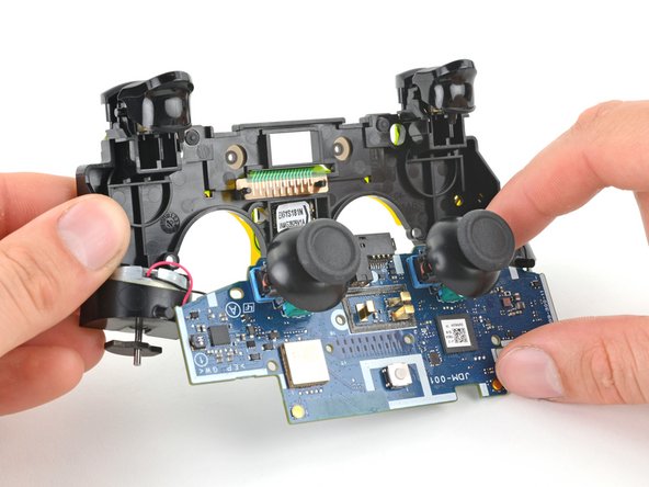

  20. DualShock 4 (CUH-ZCT1U) R2 and L2 Buttons Replacement, Remove the midframe: crwdns2935265:020crwdnd2935265:01crwdnd2935265:02crwdne2935265:0 DualShock 4 (CUH-ZCT1U) R2 and L2 Buttons Replacement, Remove the midframe: crwdns2935265:020crwdnd2935265:02crwdnd2935265:02crwdne2935265:0
    • Grab the midframe by its plastic protrusions or the vibration motors and remove it.
    • Be careful not to separate the motherboard from the midframe, as they're only connected to each other by the vibration motor cables.
    • During reassembly, take your time positioning the midframe. Use the alignment posts to help guide it into place, and make sure the touch pad cable doesn't become trapped underneath.
  21. DualShock 4 (CUH-ZCT1U) R2 and L2 Buttons Replacement, Remove the motherboard: crwdns2935265:021crwdnd2935265:01crwdnd2935265:02crwdne2935265:0 DualShock 4 (CUH-ZCT1U) R2 and L2 Buttons Replacement, Remove the motherboard: crwdns2935265:021crwdnd2935265:02crwdnd2935265:02crwdne2935265:0
    • Be careful not to strain the vibration motor cables. Follow this guide to re-solder the vibration motors if they break off the motherboard.
    • Lift the motherboard and flip it over the bottom of the midframe, leaving the vibration motor cables attached.

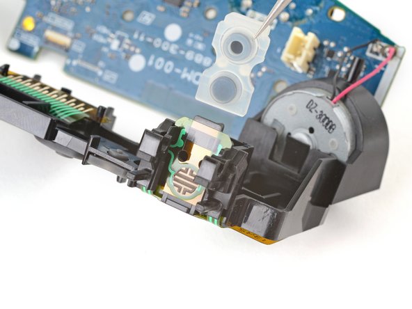

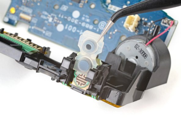

  25. DualShock 4 (CUH-ZCT1U) R2 and L2 Buttons Replacement, Remove the silicone button pads: crwdns2935265:025crwdnd2935265:01crwdnd2935265:03crwdne2935265:0 DualShock 4 (CUH-ZCT1U) R2 and L2 Buttons Replacement, Remove the silicone button pads: crwdns2935265:025crwdnd2935265:02crwdnd2935265:03crwdne2935265:0 DualShock 4 (CUH-ZCT1U) R2 and L2 Buttons Replacement, Remove the silicone button pads: crwdns2935265:025crwdnd2935265:03crwdnd2935265:03crwdne2935265:0
    • Grab the upper edge of the R1 and R2 button pad.
    • Slide the pad out of its channel in the midframe.
  26. DualShock 4 (CUH-ZCT1U) R2 and L2 Buttons Replacement: crwdns2935265:026crwdnd2935265:01crwdnd2935265:03crwdne2935265:0 DualShock 4 (CUH-ZCT1U) R2 and L2 Buttons Replacement: crwdns2935265:026crwdnd2935265:02crwdnd2935265:03crwdne2935265:0 DualShock 4 (CUH-ZCT1U) R2 and L2 Buttons Replacement: crwdns2935265:026crwdnd2935265:03crwdnd2935265:03crwdne2935265:0
    • Slide the L1 and L2 button pad out of its channel in the midframe and remove it.
    • Each pad has two plugs and an upper groove to align it with the midframe. During reassembly, ensure the plugs are inserted in their holes and the groove is hooked onto the tab in the midframe.
