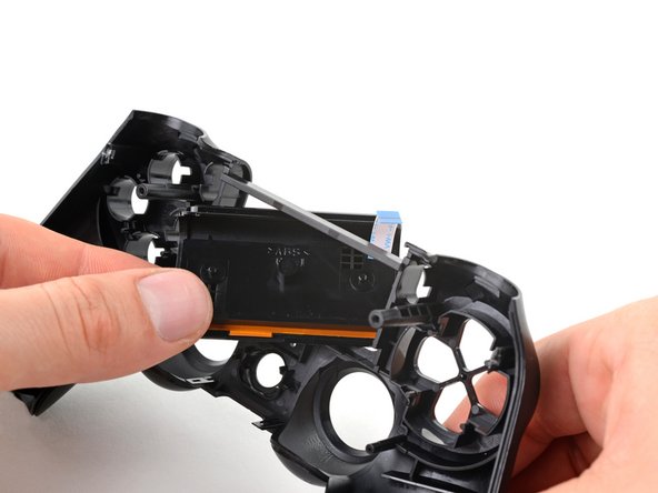

    1. DualShock 4 (CUH-ZCT1U) Front Case Replacement, Front Case: crwdns2935265:024crwdnd2935265:01crwdnd2935265:03crwdne2935265:0 DualShock 4 (CUH-ZCT1U) Front Case Replacement, Front Case: crwdns2935265:024crwdnd2935265:02crwdnd2935265:03crwdne2935265:0 DualShock 4 (CUH-ZCT1U) Front Case Replacement, Front Case: crwdns2935265:024crwdnd2935265:03crwdnd2935265:03crwdne2935265:0
      • Lift the bottom edge of the touch pad.
      • Rotate the touch pad and slide it through its cutout in the front case to remove it.
      • You're now left with the front case.
      • During reassembly, make sure the cable doesn't get stuck under the cutout in the front case.
