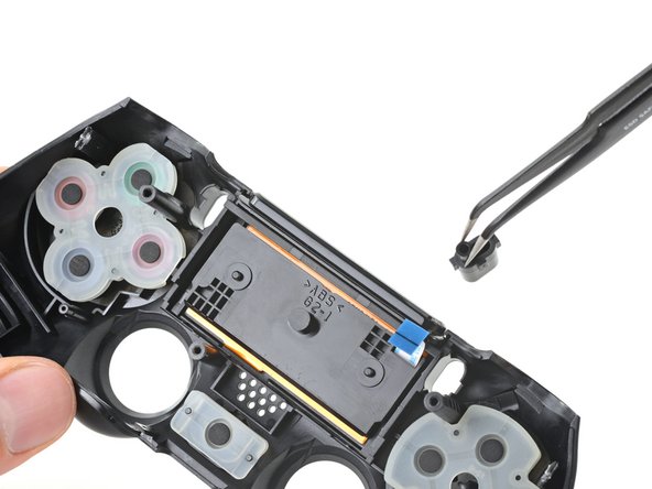

  21. DualShock 4 (CUH-ZCT1U) Buttons Replacement, Remove the Share and Options buttons: crwdns2935265:021crwdnd2935265:01crwdnd2935265:03crwdne2935265:0 DualShock 4 (CUH-ZCT1U) Buttons Replacement, Remove the Share and Options buttons: crwdns2935265:021crwdnd2935265:02crwdnd2935265:03crwdne2935265:0 DualShock 4 (CUH-ZCT1U) Buttons Replacement, Remove the Share and Options buttons: crwdns2935265:021crwdnd2935265:03crwdnd2935265:03crwdne2935265:0
    • Remove the Share and Options buttons from the front case.
    • During reassembly, there's only one way for each button to insert. If one doesn't fit, flip it and try the other recess.
    On the model CUH-ZCT2E the share and options buttons are not removable. Skip this step.
    Konrad Skeri Ekblad - crwdns2934203:0crwdne2934203:0
  22. DualShock 4 (CUH-ZCT1U) Buttons Replacement, Remove the silicone button pads: crwdns2935265:022crwdnd2935265:01crwdnd2935265:03crwdne2935265:0 DualShock 4 (CUH-ZCT1U) Buttons Replacement, Remove the silicone button pads: crwdns2935265:022crwdnd2935265:02crwdnd2935265:03crwdne2935265:0 DualShock 4 (CUH-ZCT1U) Buttons Replacement, Remove the silicone button pads: crwdns2935265:022crwdnd2935265:03crwdnd2935265:03crwdne2935265:0
    • Remove the three silicone button pads from their buttons in the front case:
    • The squared off pad for the directional pad
    • The rounded pad for the action buttons
    • The small pad for the home button
    • If you wish to remove the silicone button pads for the touch pad, Share, and Options buttons, follow this step. Otherwise, continue for the standard set of buttons.
    • During reassembly, align the pads over their cutouts in the front case and apply pressure to secure them. The directional pad and action button pad can be rotated in any direction. Orient the home button pad with the opening of the U-shaped cutout facing the touch pad.
  23. DualShock 4 (CUH-ZCT1U) Buttons Replacement, Remove the remaining buttons: crwdns2935265:023crwdnd2935265:01crwdnd2935265:03crwdne2935265:0 DualShock 4 (CUH-ZCT1U) Buttons Replacement, Remove the remaining buttons: crwdns2935265:023crwdnd2935265:02crwdnd2935265:03crwdne2935265:0 DualShock 4 (CUH-ZCT1U) Buttons Replacement, Remove the remaining buttons: crwdns2935265:023crwdnd2935265:03crwdnd2935265:03crwdne2935265:0
    • Remove the directional pad, action buttons, and home button from the front case.
    • During reassembly, use the alignment tabs to orient each button into its recess. Each one is keyed specifically for its recess and proper orientation.
