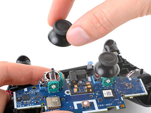

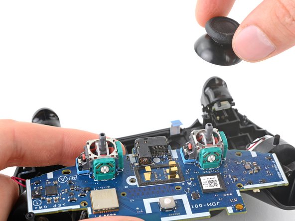

  21. DualShock 4 (CUH-ZCT1U) Analog Stick Covers Replacement, Remove the analog stick covers: crwdns2935265:021crwdnd2935265:01crwdnd2935265:03crwdne2935265:0 DualShock 4 (CUH-ZCT1U) Analog Stick Covers Replacement, Remove the analog stick covers: crwdns2935265:021crwdnd2935265:02crwdnd2935265:03crwdne2935265:0 DualShock 4 (CUH-ZCT1U) Analog Stick Covers Replacement, Remove the analog stick covers: crwdns2935265:021crwdnd2935265:03crwdnd2935265:03crwdne2935265:0
    • Grab and pull the analog stick covers straight off their modules.
    • During reassembly, rotate and press the covers until they slide onto the modules.
