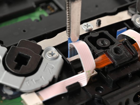

  19. DualSense Edge Rear Microphone Replacement, Remove the back button ribbon cable: crwdns2935265:019crwdnd2935265:01crwdnd2935265:02crwdne2935265:0 DualSense Edge Rear Microphone Replacement, Remove the back button ribbon cable: crwdns2935265:019crwdnd2935265:02crwdnd2935265:02crwdne2935265:0
    • Use a pair of tweezers to disconnect the RB back button ribbon cable connector from the motherboard by griping the blue tab on the ribbon cable and pulling away from the connector.
    • The RB back button has an "R" engraved on the bracket and it's to your left.
