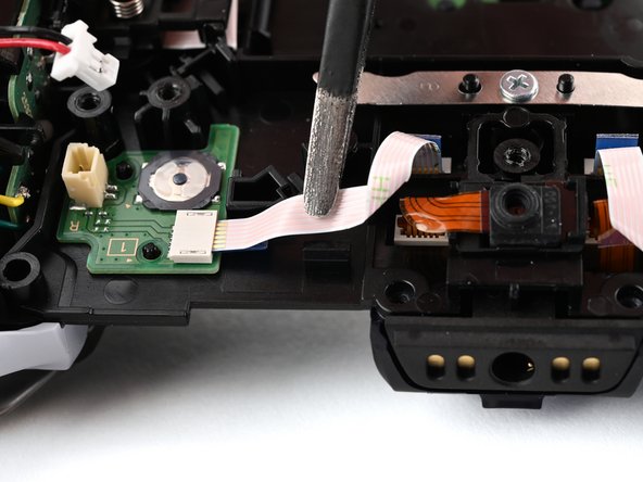

    1. DualSense Edge Back Button Boards Replacement, Disconnect the vibration motor cable: crwdns2935265:022crwdnd2935265:01crwdnd2935265:02crwdne2935265:0 DualSense Edge Back Button Boards Replacement, Disconnect the vibration motor cable: crwdns2935265:022crwdnd2935265:02crwdnd2935265:02crwdne2935265:0
      • These instructions are for the RB back button board, which is to your left. The instructions are identical for the LB back button board.
      • Use a pair of tweezers to disconnect the vibration motor cable from the back button board by lifting the JST connector out of its socket.
      • Only pull on the connector. Pulling on the wires may break them.
    2. DualSense Edge Back Button Boards Replacement, Disconnect the back button ribbon cable: crwdns2935265:023crwdnd2935265:01crwdnd2935265:02crwdne2935265:0 DualSense Edge Back Button Boards Replacement, Disconnect the back button ribbon cable: crwdns2935265:023crwdnd2935265:02crwdnd2935265:02crwdne2935265:0
      • Use a pair of tweezers to move the back button ribbon cable out from its plastic clip.
    3. DualSense Edge Back Button Boards Replacement: crwdns2935265:024crwdnd2935265:01crwdnd2935265:02crwdne2935265:0 DualSense Edge Back Button Boards Replacement: crwdns2935265:024crwdnd2935265:02crwdnd2935265:02crwdne2935265:0
      • Use a pair of tweezers to disconnect the back button board ribbon cable by gripping the blue tab and pulling away from the back button board.
    4. DualSense Edge Back Button Boards Replacement, Remove the back button board: crwdns2935265:025crwdnd2935265:01crwdnd2935265:02crwdne2935265:0 DualSense Edge Back Button Boards Replacement, Remove the back button board: crwdns2935265:025crwdnd2935265:02crwdnd2935265:02crwdne2935265:0
      • Insert a pair of angled tweezers under the bottom inside corner of the back button board.
      • Use the tweezers to pry up the back button board until it comes free of the adhesive underneath it.
    5. DualSense Edge Back Button Boards Replacement: crwdns2935265:026crwdnd2935265:01crwdnd2935265:02crwdne2935265:0 DualSense Edge Back Button Boards Replacement: crwdns2935265:026crwdnd2935265:02crwdnd2935265:02crwdne2935265:0
      • Use a pair of tweezers or your fingers to lift and remove the back button board.
