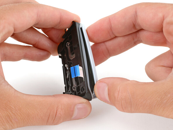

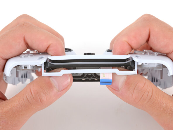

  28. DualSense Controller V5 Touchpad Replacement, Touchpad: crwdns2935265:028crwdnd2935265:01crwdnd2935265:03crwdne2935265:0 DualSense Controller V5 Touchpad Replacement, Touchpad: crwdns2935265:028crwdnd2935265:02crwdnd2935265:03crwdne2935265:0 DualSense Controller V5 Touchpad Replacement, Touchpad: crwdns2935265:028crwdnd2935265:03crwdnd2935265:03crwdne2935265:0
    • Swing the bottom of the touchpad up and away from the controller to remove it.
    • During reassembly:
    • Insert the touchpad through the back of the case and hook the top edge into place.
    • Make sure the touchpad cable doesn't get trapped between the case and the touchpad.
    • Push the bottom edge of the touchpad firmly into place, making sure the circular alignment posts snap into place and are sitting flush in their cutouts.
    • Check the front edge of the touchpad and make sure the thin strip of plastic on the front shell isn't wedged under the touchpad. If it is, remove the touchpad and reinsert it so the thin strip is parallel to the touchpad.

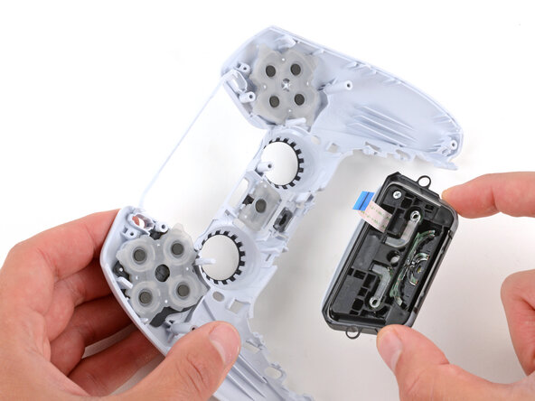

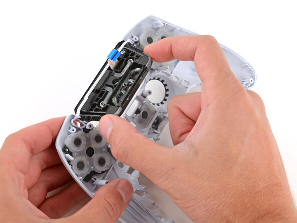

  29. DualSense Controller V5 Touchpad Replacement, Remove the touchpad: crwdns2935265:029crwdnd2935265:01crwdnd2935265:02crwdne2935265:0 DualSense Controller V5 Touchpad Replacement, Remove the touchpad: crwdns2935265:029crwdnd2935265:02crwdnd2935265:02crwdne2935265:0
    • Use your fingers to push down on the front of the touchpad until it detaches from the shell.
    • You should feel and hear a "click" as the touchpad detaches.

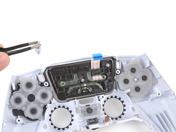

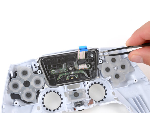

  30. DualSense Controller V5 Touchpad Replacement, Remove the touchpad screw: crwdns2935265:030crwdnd2935265:01crwdnd2935265:02crwdne2935265:0 DualSense Controller V5 Touchpad Replacement, Remove the touchpad screw: crwdns2935265:030crwdnd2935265:02crwdnd2935265:02crwdne2935265:0
    • Use a Phillips screwdriver to remove the 6.5 mm‑long screw securing the touchpad.

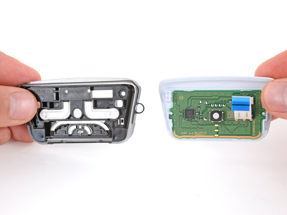

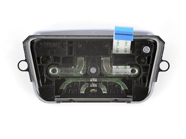

  31. DualSense Controller V5 Touchpad Replacement, Remove the touchpad: crwdns2935265:031crwdnd2935265:01crwdnd2935265:03crwdne2935265:0 DualSense Controller V5 Touchpad Replacement, Remove the touchpad: crwdns2935265:031crwdnd2935265:02crwdnd2935265:03crwdne2935265:0 DualSense Controller V5 Touchpad Replacement, Remove the touchpad: crwdns2935265:031crwdnd2935265:03crwdnd2935265:03crwdne2935265:0
    • The touchpad is secured to its bracket by two clips—a circular one that snaps into place, and a rectangular one that slides into place.
    • Use your fingers to pull up the left side of the touchpad to unclip it.
    • Slide the right side of the touchpad out from its clip and remove it.
    • If your replacement touchpad doesn't come with a cable installed, transfer the one from your original touchpad to the new one.

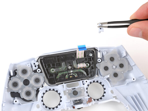

  32. DualSense Controller V5 Touchpad Replacement, Remove the Options and Create buttons: crwdns2935265:032crwdnd2935265:01crwdnd2935265:03crwdne2935265:0 DualSense Controller V5 Touchpad Replacement, Remove the Options and Create buttons: crwdns2935265:032crwdnd2935265:02crwdnd2935265:03crwdne2935265:0 DualSense Controller V5 Touchpad Replacement, Remove the Options and Create buttons: crwdns2935265:032crwdnd2935265:03crwdnd2935265:03crwdne2935265:0
    • Use tweezers or your fingers to remove the Options and Create buttons.
