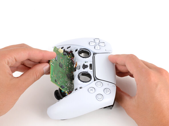

  23. DualSense Controller V5 Microphone Replacement, Reposition the motherboard: crwdns2935265:023crwdnd2935265:01crwdnd2935265:02crwdne2935265:0 DualSense Controller V5 Microphone Replacement, Reposition the motherboard: crwdns2935265:023crwdnd2935265:02crwdnd2935265:02crwdne2935265:0
    • Throughout the rest of your repair, be very careful not to strain the delicate wires attached to the bottom edge of the board. They can easily tear, requiring soldering to fix them.
    • Use your fingers to gently push the joysticks through their cutouts on the shell to separate the motherboard.
  24. DualSense Controller V5 Microphone Replacement: crwdns2935265:024crwdnd2935265:01crwdnd2935265:02crwdne2935265:0 DualSense Controller V5 Microphone Replacement: crwdns2935265:024crwdnd2935265:02crwdnd2935265:02crwdne2935265:0
    • Carefully flip the motherboard down so the joysticks are facing up.
  25. DualSense Controller V5 Microphone Replacement, Speaker note: crwdns2935265:025crwdnd2935265:01crwdnd2935265:02crwdne2935265:0 DualSense Controller V5 Microphone Replacement, Speaker note: crwdns2935265:025crwdnd2935265:02crwdnd2935265:02crwdne2935265:0
    • The speaker may have fallen out when repositioning the motherboard. If it did, set it aside for reassembly. If it stayed in place on the motherboard or is in its recess in the front case, you can leave it in place.
    • During reassembly, place the speaker in its recess so the foam pad is on the left and the spring contacts are on the right.
  26. DualSense Controller V5 Microphone Replacement, Flip the controller over: crwdns2935265:026crwdnd2935265:01crwdnd2935265:02crwdne2935265:0 DualSense Controller V5 Microphone Replacement, Flip the controller over: crwdns2935265:026crwdnd2935265:02crwdnd2935265:02crwdne2935265:0
    • Grip the controller in one hand and motherboard in the other and carefully flip them over.

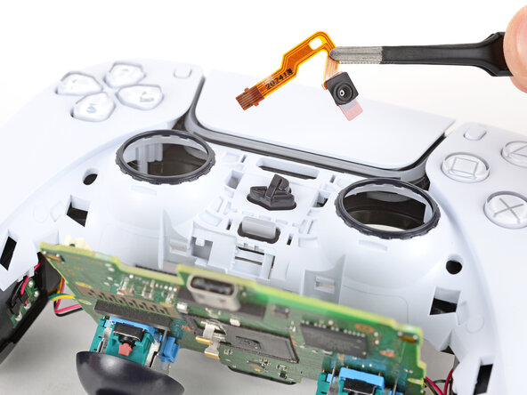

  27. DualSense Controller V5 Microphone Replacement, Remove the upper microphone: crwdns2935265:027crwdnd2935265:01crwdnd2935265:02crwdne2935265:0 DualSense Controller V5 Microphone Replacement, Remove the upper microphone: crwdns2935265:027crwdnd2935265:02crwdnd2935265:02crwdne2935265:0
    • Use tweezers to remove the upper microphone, threading its cable through the cutout in the case.
    • During reassembly, make sure the microphone has its rubber gasket and that the alignment tab goes into its cutout.
