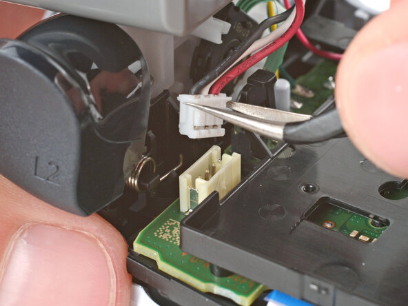

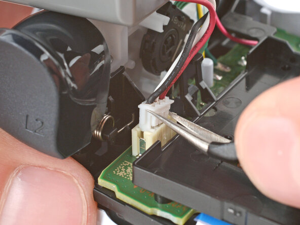

  16. DualSense Controller V5 Battery Replacement: crwdns2935265:016crwdnd2935265:01crwdnd2935265:03crwdne2935265:0 DualSense Controller V5 Battery Replacement: crwdns2935265:016crwdnd2935265:02crwdnd2935265:03crwdne2935265:0 DualSense Controller V5 Battery Replacement: crwdns2935265:016crwdnd2935265:03crwdnd2935265:03crwdne2935265:0
    • Use a pair of angled tweezers to firmly grip the short sides of the battery connector.
    • To get a stronger hold on the connector, grip the tweezers as close to the connector as you can.
    • Rock the connector side‑to‑side to walk it out of its socket and disconnect it.

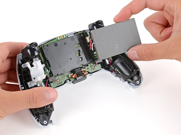

  17. DualSense Controller V5 Battery Replacement, Remove the battery: crwdns2935265:017crwdnd2935265:01crwdnd2935265:01crwdne2935265:0
    • Remove the battery.
For optimal performance, calibrate your newly installed battery after completing this guide.
