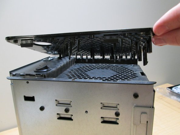

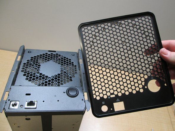

    • Press tabs to release back cover and lift off
  5. Drobo FS DRDS2-A Power Switch Replacement: crwdns2935265:05crwdnd2935265:01crwdnd2935265:02crwdne2935265:0 Drobo FS DRDS2-A Power Switch Replacement: crwdns2935265:05crwdnd2935265:02crwdnd2935265:02crwdne2935265:0

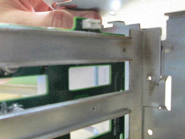

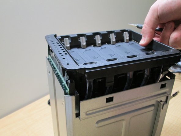

    • Push tabs in and carefully pull out the front facer and drive shelves
  6. Drobo FS DRDS2-A Power Switch Replacement: crwdns2935265:06crwdnd2935265:01crwdnd2935265:02crwdne2935265:0 Drobo FS DRDS2-A Power Switch Replacement: crwdns2935265:06crwdnd2935265:02crwdnd2935265:02crwdne2935265:0

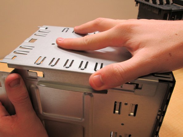

    • Unscrew the back face by removing the screw on the back sides, then slide top face apart from the others
    • If you have a Drobo 5N2, you may also need to remove the 3 screws on each side.

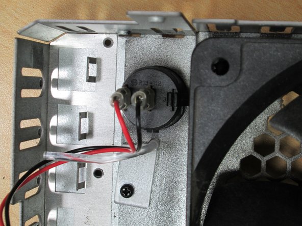

  7. Drobo FS DRDS2-A Power Switch Replacement: crwdns2935265:07crwdnd2935265:01crwdnd2935265:02crwdne2935265:0 Drobo FS DRDS2-A Power Switch Replacement: crwdns2935265:07crwdnd2935265:02crwdnd2935265:02crwdne2935265:0
    • Carefully unplug the Power Switch and Fan wires.
  8. Drobo FS DRDS2-A Power Switch Replacement: crwdns2935265:08crwdnd2935265:01crwdnd2935265:01crwdne2935265:0
    • Press tabs on Power Switch to release the Power Switch and Push out.
    • A Spudger like object is helpful for pushing in the tabs if the fan is not removed also
  9. Drobo FS DRDS2-A Power Switch Replacement: crwdns2935265:09crwdnd2935265:01crwdnd2935265:02crwdne2935265:0 Drobo FS DRDS2-A Power Switch Replacement: crwdns2935265:09crwdnd2935265:02crwdnd2935265:02crwdne2935265:0
    • Finally pull the old switch out and pop the new one in.

I took my Drobo apart and the printed numbers on the switch are R13-112. I ordered these on Amazon:
https://www.amazon.com/Twidec-Rocker-Tog...
I put it in, crossed my fingers, and BAM, worked like a charm. Hope that helps all the future DIY’ers.
