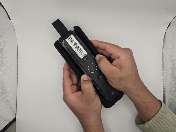

    • Peel the backing off of the speaker.

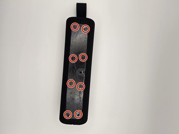

    • Remove eight 7.9 mm screws using the Phillips #00 screwdriver.
    • Gently pull apart the grille on the sides of the speaker.

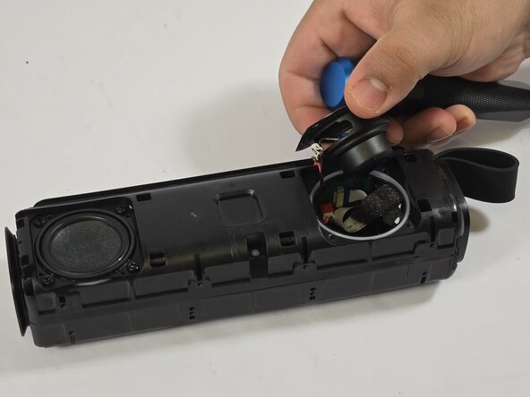

    • Remove four 9.6 mm screws from one of the speaker drivers using the Phillips #00 screwdriver.
    • Gently flip the driver up away from you.

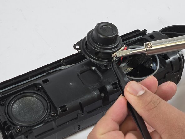

    • Apply a bead of flux. Press the soldering iron tip firmly to melt the solder.
    • If you heat the area for more than 10 seconds, the excessive heat may damage the wires.
    • Repeat for the other speaker driver if needed.
