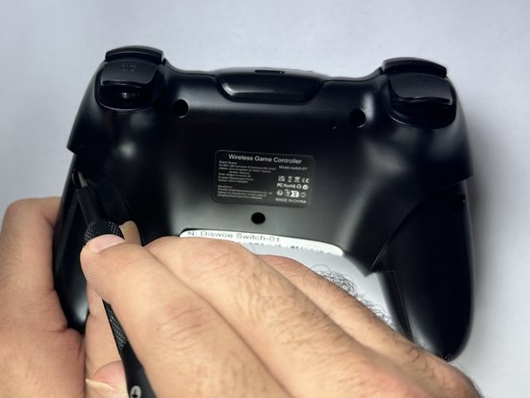

    • Use a Phillips screwdriver to remove the two screws at the bottom of the hand grips.
    • Remove the handgrips from the controller.

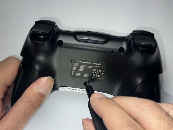

    • Turn the controller over so the bottom is facing up.
    • Use a Phillips screwdriver to remove the five screws from the back case.

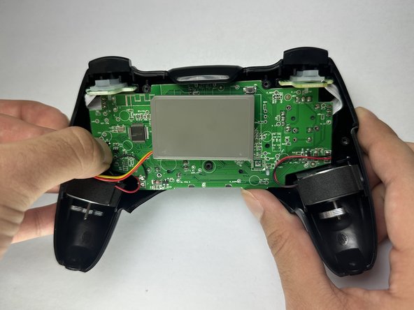

    • Use both hands to carefully remove the back cover.
    • For help removing the back cover, use a spudger to pry along the seam between the top and bottom case.
    • Don't pull the back cover off quickly or forcefully as the wires that are connected are easy to break.

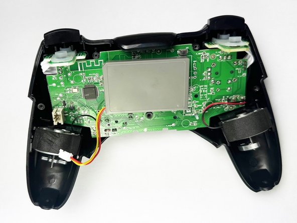

    • Push on alternating sides of the battery connector to "walk" it out of its socket.
    • It may take a lot of alternating before the connector comes out. Be patient, and don't pull on the cables.
    • If that doesn't work, use a pair of tweezers to firmly grip the sides of the connector and pull straight away from the socket. Hold the tweezers closer to the connector to get a better grip.
    • Additionally, if the previous step didn’t work, use the arms of a pair of sharp tweezers to gently push the connector out of its socket by inserting them into the cutouts.
    • If you're having trouble, try rocking the connector side-to-side to loosen it.
    • To reconnect the cable, insert the connector into its socket and push on the edges until it's fully seated

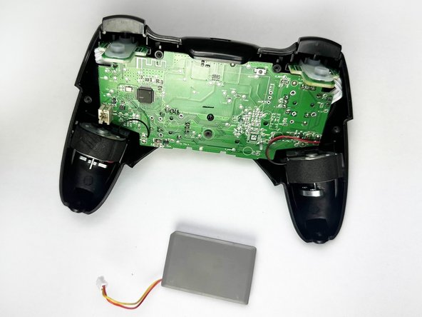

    • Remove the battery from the main circuit board.
    • The battery is held in place by sticky foam. If you aren't able to remove it easily by hand, use a spudger to gently loosen the adhesive and then remove the battery.
