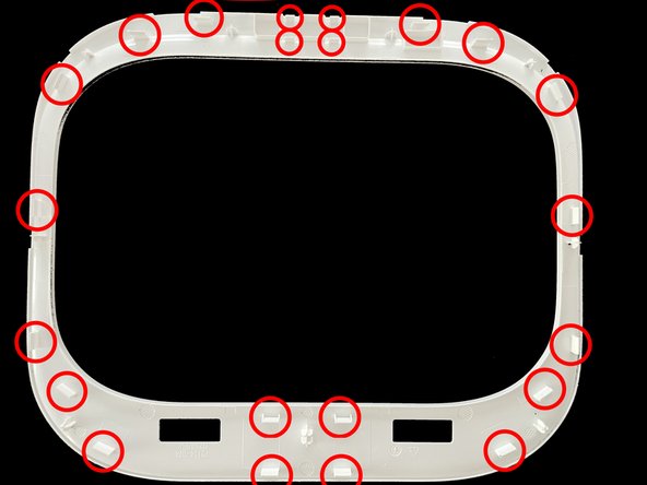

  2. Disassembly of the Dreame L10s Ultra base station, Remove the top cover: crwdns2935265:02crwdnd2935265:01crwdnd2935265:03crwdne2935265:0 Disassembly of the Dreame L10s Ultra base station, Remove the top cover: crwdns2935265:02crwdnd2935265:02crwdnd2935265:03crwdne2935265:0 Disassembly of the Dreame L10s Ultra base station, Remove the top cover: crwdns2935265:02crwdnd2935265:03crwdnd2935265:03crwdne2935265:0
    Jimmy
    $7.95
    • The top cover is held on with clips.
    • Carefully move the Jimmy underneath. Place the tool on an edge and slowly work your way around the casing to avoid damage.

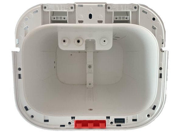

    • You have to be especially careful around the area of the three buttons (see picture 3).
  3. Disassembly of the Dreame L10s Ultra base station, Remove the upper screws.: crwdns2935265:03crwdnd2935265:01crwdnd2935265:01crwdne2935265:0
    • Take out the two marked screws using a PH2 screwdriver.

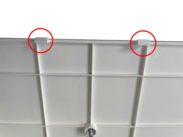

  4. Disassembly of the Dreame L10s Ultra base station, Remove the cover from the bottom: crwdns2935265:04crwdnd2935265:01crwdnd2935265:02crwdne2935265:0 Disassembly of the Dreame L10s Ultra base station, Remove the cover from the bottom: crwdns2935265:04crwdnd2935265:02crwdnd2935265:02crwdne2935265:0
    • Remove the seven screws on the bottom of the base station with a PH2 screwdriver
    • Detach the plate on the underside. To do this, take care of the clips in Fig. 2 above the label with the type designation.
