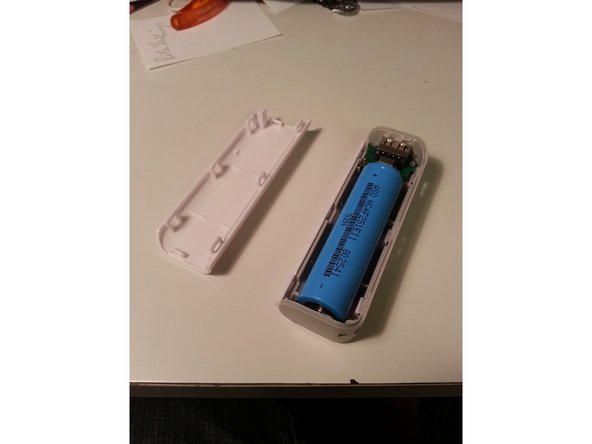

    • Insert small screwdriver into gap between the two shell halves on one of the three tabs and pry off. Photos should only give clues for the position and shape of the tabs! Carefully fold away housing halves, note rear tabs

    • Remove the battery

    • Gently pry wire with spring at negative pole down out of plastic tab and lift. Circuit hangs on the wire and tilts up, pull out
