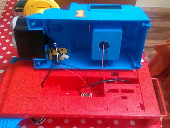

  5. Disassembling the Thomas Ride On Train, Removing the side panels: crwdns2935265:05crwdnd2935265:01crwdnd2935265:01crwdne2935265:0
    • Over the wheel arches are 2 more plastic panels, they are held in place by screws. Note that the outer screws are a smaller size.
  6. Disassembling the Thomas Ride On Train, Removing the body: crwdns2935265:06crwdnd2935265:01crwdnd2935265:02crwdne2935265:0 Disassembling the Thomas Ride On Train, Removing the body: crwdns2935265:06crwdnd2935265:02crwdnd2935265:02crwdne2935265:0
    • The next 5 screws hold the body to the chassis. The top also is clipped in place at the back
    • You can access most of the components at this point including disconnecting the motor and the power switch

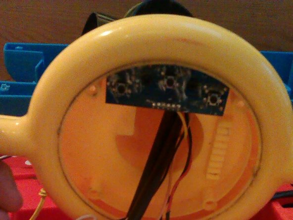

  9. Disassembling the Thomas Ride On Train, Removing the handlebars: crwdns2935265:09crwdnd2935265:01crwdnd2935265:01crwdne2935265:0
    • A single screw inside the chimney holds this in place, again you may need a short screwdriver to access this

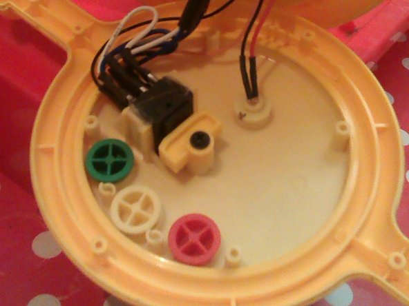

  10. Disassembling the Thomas Ride On Train, Removing the console: crwdns2935265:010crwdnd2935265:01crwdnd2935265:03crwdne2935265:0 Disassembling the Thomas Ride On Train, Removing the console: crwdns2935265:010crwdnd2935265:02crwdnd2935265:03crwdne2935265:0 Disassembling the Thomas Ride On Train, Removing the console: crwdns2935265:010crwdnd2935265:03crwdnd2935265:03crwdne2935265:0
    • The console is held in place by the 4 inner screws, note you don't need to remove the outer screws or screws in the handlebars
    • Note how the block attached to the lever is positioned against the switch. In my train this was 180degrees reversed and hence the lever did not do anything.
    • The three buttons need to be correctly orientated, they have little bars to fit into slots
    • Note the newer model may look slightly different to this
