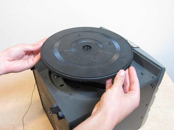

    • Lift the lid to get to the turntable.
    • Using the appropriate tools (needle-nose pliers, tweezers, screwdriver, etc.), remove the snap ring from the center of the turntable. The snap-ring is the small metal ring around the axel of the turntable.
    • The snap-ring is hard to remove so be patient and don't be afraid to use some force.
    • Feel free to use whatever tool(s) that will remove the snap-ring. The above list of tools are just a suggestions.
  3. Disassembling the Teac DC-D2831: crwdns2935265:03crwdnd2935265:01crwdnd2935265:02crwdne2935265:0 Disassembling the Teac DC-D2831: crwdns2935265:03crwdnd2935265:02crwdnd2935265:02crwdne2935265:0
    • Gently lift the turntable from the rest of the device.
    • If the device has a faulty belt, see the belt repair guide here: Belt Repair Guide

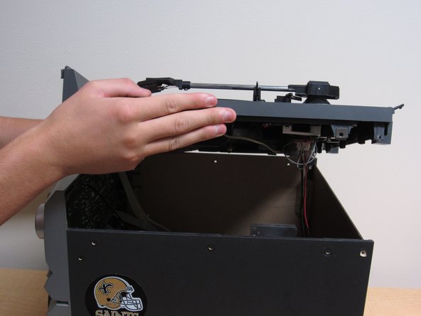

  4. Disassembling the Teac DC-D2831: crwdns2935265:04crwdnd2935265:01crwdnd2935265:01crwdne2935265:0
    • Remove the screws on the side of the device using a Phillips #2 screwdriver.
    • When removing the screws, take note of which screws go where.
    • 27.0mm
    • 19.8mm
    • 12.0mm
  5. Disassembling the Teac DC-D2831: crwdns2935265:05crwdnd2935265:01crwdnd2935265:02crwdne2935265:0 Disassembling the Teac DC-D2831: crwdns2935265:05crwdnd2935265:02crwdnd2935265:02crwdne2935265:0
    • Lift the base that the turntable was resting on from the rest of the device.
    • Remove the base slowly so to not sever the connection with the wire attached from the base to the circuit board.
