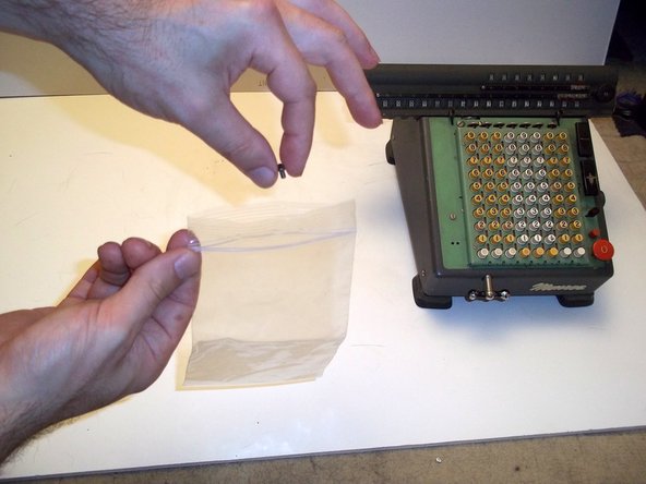

    • Remove the left side screw.
    • Screw: 4-48 x 1/4", head 1/4" x 1/16"
    • Put it in a bag!
    • You should label each bag with the model number and serial number.
    • You can find the serial number by turning the calculator upside down and peering into the slot cut into the bottom, which gives you the model number and serial number.
    • Label the bag 1 so that you know where in the sequence this part was pulled off.

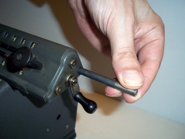

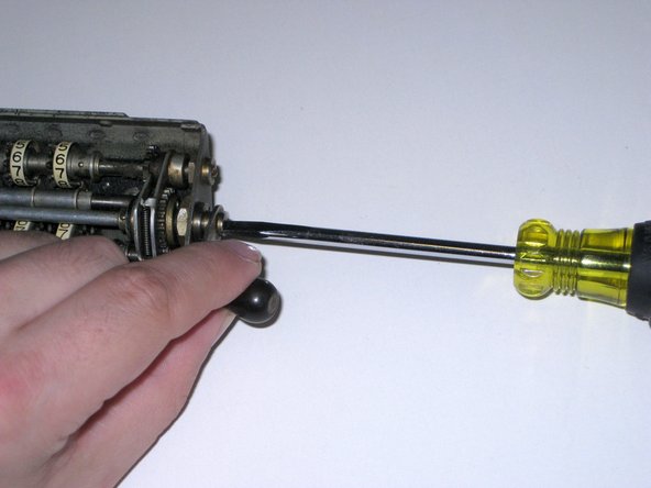

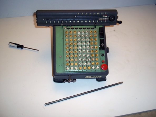

    • Get something pointy, like a small screwdriver, and push it into the hole on the left side of the carriage that was revealed by the screw being removed.
    • This will push out the carriage shaft from the right side. Grab it and pull it out all the way.
    • Put the carriage shaft in your box of parts.

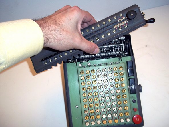

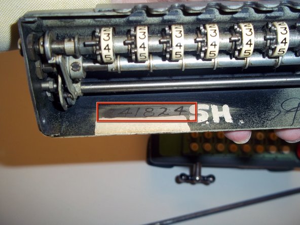

    • Pull back on the two carriage latches.
    • With the other hand, lift the carriage up and away.
    • On the underside of the carriage is inscribed the serial number of the machine, in case you couldn't read it from the slot in the underside.
    • Mine is serial number 241824. Also, apparently Stapler Guy was really possessive of this calculator.

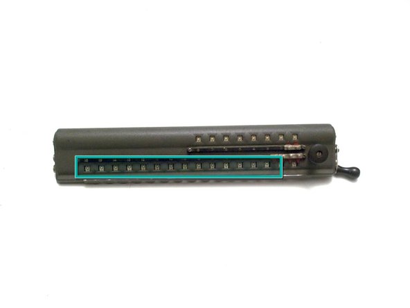

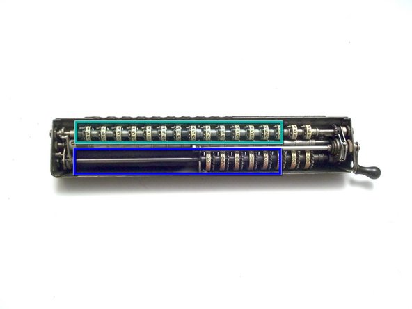

  7. Disassembling a Monroe LA-160 calculator, Carriage Parts (top): crwdns2935265:07crwdnd2935265:01crwdnd2935265:03crwdne2935265:0 Disassembling a Monroe LA-160 calculator, Carriage Parts (top): crwdns2935265:07crwdnd2935265:02crwdnd2935265:03crwdne2935265:0 Disassembling a Monroe LA-160 calculator, Carriage Parts (top): crwdns2935265:07crwdnd2935265:03crwdnd2935265:03crwdne2935265:0
    • Upper Dials. Consists of eight individual dials with black and red digits. Shows the multiplier in multiplication, and the result of division.
    • Lower Dials. Consists of sixteen individual dials, showing the result of addition and multiplication, the remainder in subtraction, and the dividend in division.
    • Dials Clear-out Crank. Rotate forwards one turn, stopping at bottom, to clear out upper dials. Backwards for lower dials.

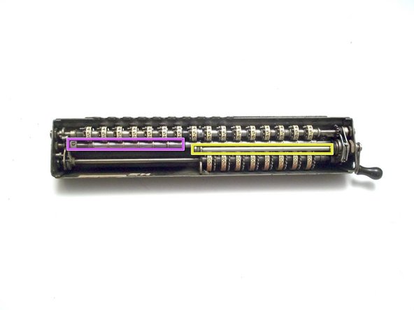

  8. Disassembling a Monroe LA-160 calculator, Carriage Parts (bottom): crwdns2935265:08crwdnd2935265:01crwdnd2935265:03crwdne2935265:0 Disassembling a Monroe LA-160 calculator, Carriage Parts (bottom): crwdns2935265:08crwdnd2935265:02crwdnd2935265:03crwdne2935265:0 Disassembling a Monroe LA-160 calculator, Carriage Parts (bottom): crwdns2935265:08crwdnd2935265:03crwdnd2935265:03crwdne2935265:0
    • Clutch mechanism. Drives either the lower shaft or upper shaft, but not both.
    • Lower Dials shaft and wheels.
    • Upper Dials shaft and wheels.
    • Zeroing shaft.
    • Carriage lifting shaft, only active when zeroing the Lower Dials.

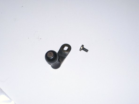

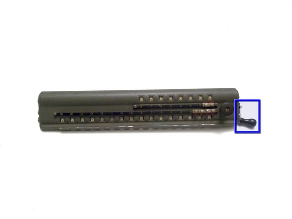

  10. Disassembling a Monroe LA-160 calculator, Removing the zeroing crank: crwdns2935265:010crwdnd2935265:01crwdnd2935265:03crwdne2935265:0 Disassembling a Monroe LA-160 calculator, Removing the zeroing crank: crwdns2935265:010crwdnd2935265:02crwdnd2935265:03crwdne2935265:0 Disassembling a Monroe LA-160 calculator, Removing the zeroing crank: crwdns2935265:010crwdnd2935265:03crwdnd2935265:03crwdne2935265:0
    • Turn the carriage to the right side.
    • Holding on to the crank, remove this screw.
    • Put the crank and screw in bag #1.

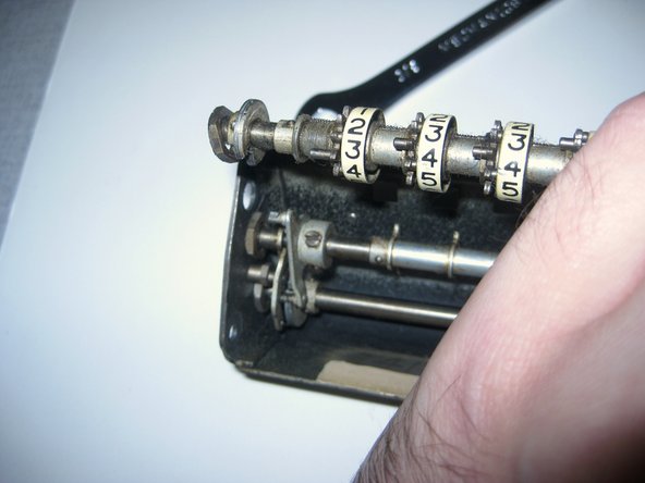

  11. Disassembling a Monroe LA-160 calculator, Removing the lower dials: crwdns2935265:011crwdnd2935265:01crwdnd2935265:03crwdne2935265:0 Disassembling a Monroe LA-160 calculator, Removing the lower dials: crwdns2935265:011crwdnd2935265:02crwdnd2935265:03crwdne2935265:0 Disassembling a Monroe LA-160 calculator, Removing the lower dials: crwdns2935265:011crwdnd2935265:03crwdnd2935265:03crwdne2935265:0

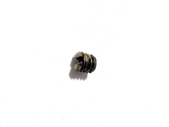

    • Remove this set screw.
    • Set screw: 5-44 x 1/8"
    • Put the set screw in bag #1.

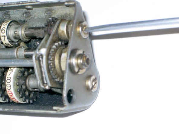

  12. Disassembling a Monroe LA-160 calculator: crwdns2935265:012crwdnd2935265:01crwdnd2935265:02crwdne2935265:0 Disassembling a Monroe LA-160 calculator: crwdns2935265:012crwdnd2935265:02crwdnd2935265:02crwdne2935265:0
    • Turn the carriage to the left side.
    • Place the set screw in bag #1.
    • The set screws are used to align the shaft along its axis.

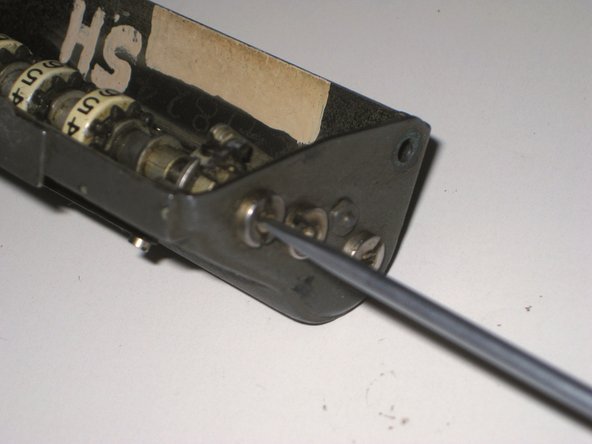

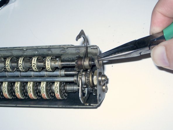

  13. Disassembling a Monroe LA-160 calculator: crwdns2935265:013crwdnd2935265:01crwdnd2935265:02crwdne2935265:0 Disassembling a Monroe LA-160 calculator: crwdns2935265:013crwdnd2935265:02crwdnd2935265:02crwdne2935265:0
    • This spring on the right side of the carriage needs to be removed.
    • Pull the arm on the right upwards to get better access to the spring.

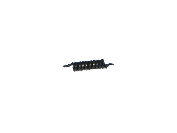

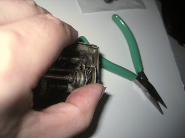

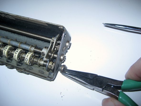

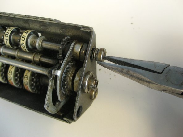

  14. Disassembling a Monroe LA-160 calculator: crwdns2935265:014crwdnd2935265:01crwdnd2935265:02crwdne2935265:0 Disassembling a Monroe LA-160 calculator: crwdns2935265:014crwdnd2935265:02crwdnd2935265:02crwdne2935265:0
    • With the arm raised, use needlenose pliers to pull the spring off the arms.
    • Spring: Expansion, 0.31" compressed x 0.11", wire 0.014"
    • Place the spring in bag #1.

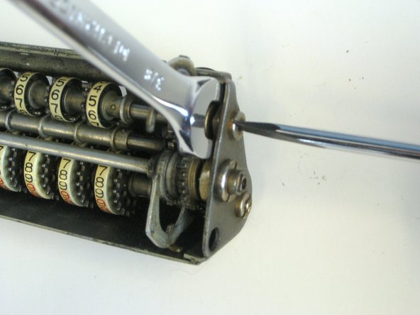

    • Spread the arms out.
    • Use a 3/8" wrench to hold the nut, and unscrew the bushing.
    • Remove the bushing, and put it in bag #1.
    • The nut stays in for now.

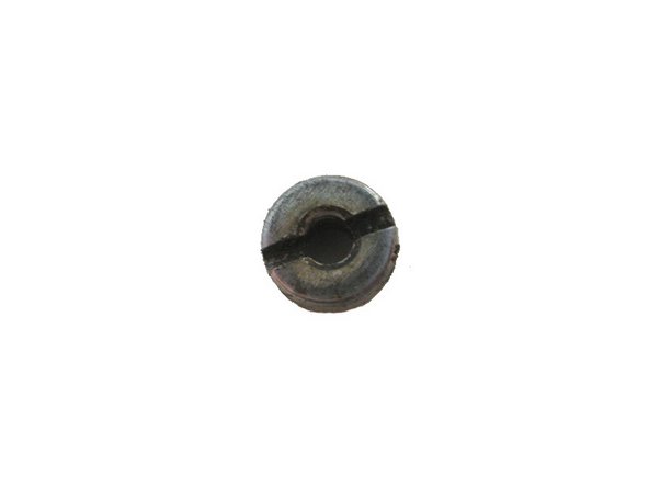

  17. Disassembling a Monroe LA-160 calculator: crwdns2935265:017crwdnd2935265:01crwdnd2935265:02crwdne2935265:0 Disassembling a Monroe LA-160 calculator: crwdns2935265:017crwdnd2935265:02crwdnd2935265:02crwdne2935265:0
    • A close-up of the bushing.
    • It is hollow and threaded on the outside, 1/4-32 x 1/8", and the head is threaded on the inside for the set screw.
    • Its head is 0.296" x 3/16"

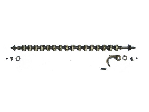

    • On the right side, lift up the Lower Dials shaft by the arm.
    • You can now get to the nut. Remove it and put it in bag #1.
  19. Disassembling a Monroe LA-160 calculator: crwdns2935265:019crwdnd2935265:01crwdnd2935265:02crwdne2935265:0 Disassembling a Monroe LA-160 calculator: crwdns2935265:019crwdnd2935265:02crwdnd2935265:02crwdne2935265:0
    • Still lifting on the right side of the shaft, turn the shaft so that the cam on the left side engages the pin.
    • Now lift up on the left side of the shaft to free it.
    • The left side nut may fall off, or not. If it tries to escape, make sure you see where it went.

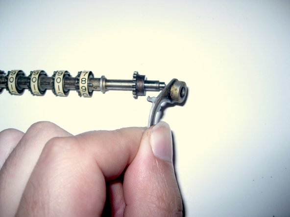

  20. Disassembling a Monroe LA-160 calculator: crwdns2935265:020crwdnd2935265:01crwdnd2935265:03crwdne2935265:0 Disassembling a Monroe LA-160 calculator: crwdns2935265:020crwdnd2935265:02crwdnd2935265:03crwdne2935265:0 Disassembling a Monroe LA-160 calculator: crwdns2935265:020crwdnd2935265:03crwdnd2935265:03crwdne2935265:0
    • Remove the nut from the left side of the shaft, or the floor, or wherever it ended up, and place it in bag #1.
    • Remove the Lower Dials shaft arm from the right side of the shaft, and place it in bag #1.

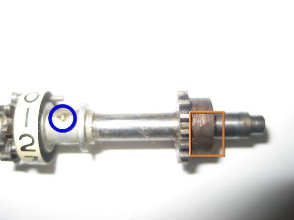

  21. Disassembling a Monroe LA-160 calculator, Removing the Lower Dials parts: crwdns2935265:021crwdnd2935265:01crwdnd2935265:02crwdne2935265:0 Disassembling a Monroe LA-160 calculator, Removing the Lower Dials parts: crwdns2935265:021crwdnd2935265:02crwdnd2935265:02crwdne2935265:0
    • The parts of the Lower Dials are fixed to the shaft using tapered pins.
    • During installation, the part is placed on the shaft, held in place, and then a hole is drilled through the part and the shaft using a taper pin drill bit.
    • Next, a taper pin is inserted into the hole until it stops, then it is pressed in with an arbor press. The pin is then cut or ground off.
    • Indicated is a hole in the Lower Dials driver gear for its taper pin.
    • In this dial spacer, the taper pin is clearly visible.
    • Rotating the shaft to the other side, we can see the over-enthusiastic application of a grinding head applied to the other end of the taper pin on the driver gear.
    • Meanwhile, the taper pin is again clearly visible on the dial spacer.
    • Removal of taper pins requires an arbor press and pin punches, and preferably a pin punch holder.
    • For this disassembly, you will need 1.1 mm or 1.0 mm pin punches, and you will need a lot of them, maybe ten or twenty, since they will often break.
    • Before you use a pin punch, cut it down to 1/4" or so using a Dremel or some other cut-off tool.
