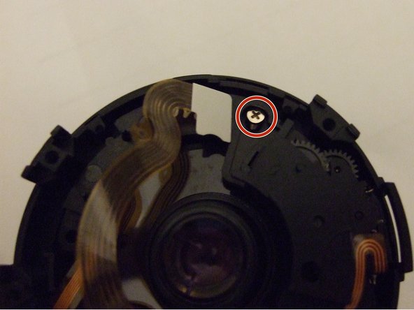

  9. Disassembling Canon EF 35-105mm f/4.5-5.6 USM Lens: crwdns2935265:09crwdnd2935265:01crwdnd2935265:02crwdne2935265:0 Disassembling Canon EF 35-105mm f/4.5-5.6 USM Lens: crwdns2935265:09crwdnd2935265:02crwdnd2935265:02crwdne2935265:0
    • Next, we will remove the autofocus mechanism.
    • Remove the two Phillips #000 screws shown.
    • Be careful with the control cables. They tear easily. The aperture control cable on this lens is damaged already.

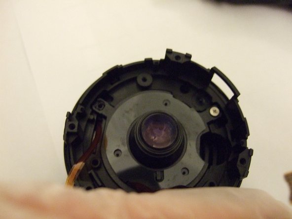

  13. Disassembling Canon EF 35-105mm f/4.5-5.6 USM Lens: crwdns2935265:013crwdnd2935265:01crwdnd2935265:01crwdne2935265:0
    • Gently rotate the aperture unit anti-clockwise so that the three ringed legs no longer lock it in place.
    • On my lens, there was one of the three legs intact, and the aperture unit was hanging off uselessly.
  14. Disassembling Canon EF 35-105mm f/4.5-5.6 USM Lens: crwdns2935265:014crwdnd2935265:01crwdnd2935265:01crwdne2935265:0
    • If your aperture unit is like mine, apply superglue around the outer rim, and replace.
    • Don't get any on the glass!
  15. Disassembling Canon EF 35-105mm f/4.5-5.6 USM Lens: crwdns2935265:015crwdnd2935265:01crwdnd2935265:01crwdne2935265:0
    • That's as far as I went - the zoom was no longer jammed, and reassembly was the best option here! Reassembly is the reverse of disassembly.
