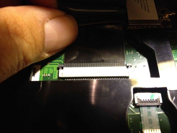

    • In this next step, the keyboard is still attached to the logic board via a flat cable. Be careful not to tear the cable or damage the connector by removing the keyboard too quickly or too abruptly or pulling it too far away from the laptop.
    • Lift the keyboard away from the laptop, starting from the top end which is nearest to the screen.
  4. Disassembling & Replacing Keyboard on Toshiba Laptop C655 Series: crwdns2935265:04crwdnd2935265:01crwdnd2935265:02crwdne2935265:0 Disassembling & Replacing Keyboard on Toshiba Laptop C655 Series: crwdns2935265:04crwdnd2935265:02crwdnd2935265:02crwdne2935265:0
    • Use the tip or the flat end of a nylon spudger to unlock the connector securing the flat cable of the keyboard to the logic board.
    • Pull the flat cable out not up.
    • When re-assembling, insert and hold the flat cable in place with one hand; use the other hand to lock the connecter using the tip or flat end of a nylon spudger. If you release the flat cable before locking the connector, it will most probably slip out.

I had to take my laptop apart to fix broken hinges which had been put in at factory was to stiff and it had cut the power connector inside. I replaced the power connector woth a new one and made a few little repairs, put everything back together but the keyboard did not work. After watching this video I redid the ribbon connection under the keyboard more carefully and and it works great. Thanks for posting this video. It was very helpful. This was my first time to work on a Laptop. Feeling great about my first laptop home repair.

I thought the ribbon might be a stupid design like GE digital phones, not so.
Pop the connector using your fingernail.
The ribbon slides into place.
great design ...
Test & good to go ...
