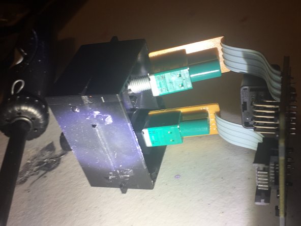

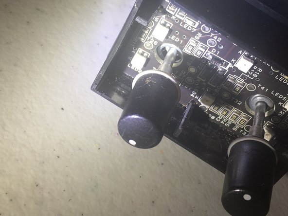

  4. Disassemble 2012 Toyota Highlander Seat Heater Switch, Lets Inspect What We Have: crwdns2935265:04crwdnd2935265:01crwdnd2935265:03crwdne2935265:0 Disassemble 2012 Toyota Highlander Seat Heater Switch, Lets Inspect What We Have: crwdns2935265:04crwdnd2935265:02crwdnd2935265:03crwdne2935265:0 Disassemble 2012 Toyota Highlander Seat Heater Switch, Lets Inspect What We Have: crwdns2935265:04crwdnd2935265:03crwdnd2935265:03crwdne2935265:0
    • The module consists of a circuit board with the two knobs protruding out to the front with another circuit board pressed into the back side.
    • In the photo you can see the potentiometer knob to the left is loose.
    • The third photo shows the two potentiometer switches and their ribbon cables connected to the backside board. The backside board can be pulled carefully straight out from its tucked position. Note that there is a mating connector holding the backside board into the front board.

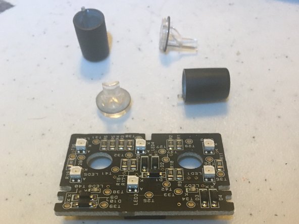

  5. Disassemble 2012 Toyota Highlander Seat Heater Switch, Get Everything Apart: crwdns2935265:05crwdnd2935265:01crwdnd2935265:02crwdne2935265:0 Disassemble 2012 Toyota Highlander Seat Heater Switch, Get Everything Apart: crwdns2935265:05crwdnd2935265:02crwdnd2935265:02crwdne2935265:0
    • In order to secure the loose potentiometer I needed to pull the knob ends off of their shafts and then work the board off of the tapered ridges around the module.
    • Hold each shaft near the circuit board and firmly but slowly pull each set of knob ends (black end piece with a clear piece and a thin gasket) away from the shaft.
    • With the knob ends removed, carefully work the circuit board out from behind using a plastic spudger or similar tool at the board edges.
  6. Disassemble 2012 Toyota Highlander Seat Heater Switch, Secure the Potentiometer: crwdns2935265:06crwdnd2935265:01crwdnd2935265:01crwdne2935265:0
    • With the board removed we can finally access the fasteners used to secure the potentiometers to the module center.
    • Here I just tightened up the nut finger tight and then realized I could get my craftsman 1/4" deep well socket over the top of the potentiometer shaft. I think the 5/16" socket is the correct fit but don't hit it too hard.
