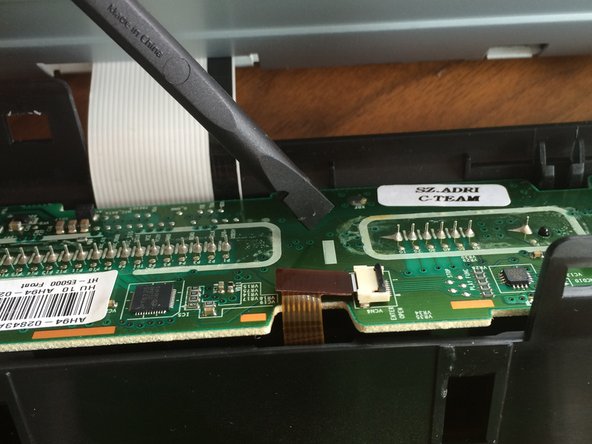

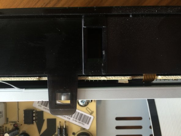

    4. Disabling the touch function, The scenic route 1/2: crwdns2935265:04crwdnd2935265:01crwdnd2935265:03crwdne2935265:0 Disabling the touch function, The scenic route 1/2: crwdns2935265:04crwdnd2935265:02crwdnd2935265:03crwdne2935265:0 Disabling the touch function, The scenic route 1/2: crwdns2935265:04crwdnd2935265:03crwdnd2935265:03crwdne2935265:0
      • Just be sure, you have disconnected the white ribbon from the mainboard, so you wouldn't damage the connector while taking the front cover off.
      • Now you have to get the metal spudger and gently work you way below the clips on the side and loosen them.
      • Then the ones at the top but careful, there are two left and right of the disk tray looking a bit different and consisting entirely out of snappy plastic.
      • Now the front cover will tilt forward.
      • Either you take the lower clips of as well, but the entire cover might jump towards you (in this case you have to make sure again, the blue ribbon is disconnected) or you just work with the gap you just created.

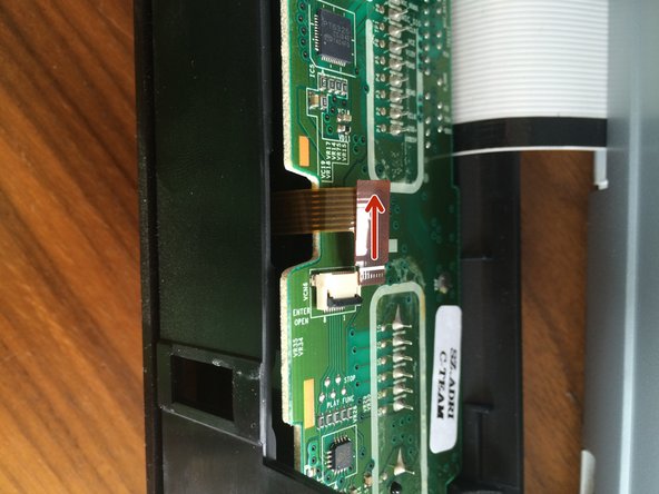

    5. Disabling the touch function, The scenic route 2/2: crwdns2935265:05crwdnd2935265:01crwdnd2935265:03crwdne2935265:0 Disabling the touch function, The scenic route 2/2: crwdns2935265:05crwdnd2935265:02crwdnd2935265:03crwdne2935265:0 Disabling the touch function, The scenic route 2/2: crwdns2935265:05crwdnd2935265:03crwdnd2935265:03crwdne2935265:0
      • Now you can take the spudger and open the little black clip on the connector holding the brown touch sensor ribbon.
      • Then just pull the brown ribbon out carefully and you are done.
    6. Disabling the touch function, The Shortcut: crwdns2935265:06crwdnd2935265:01crwdnd2935265:01crwdne2935265:0
      • Get the spudger and lift the small black clip on the white connector where the brown touch control ribbon is connected to the board.
      • Gently pull the brown ribbon out of the clip.
