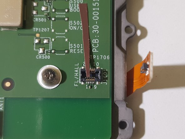

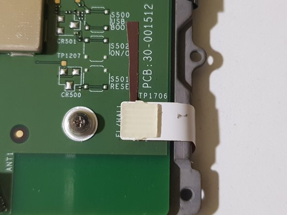

      • You will then need to cover pins 2 and 4 of the front light connector.
      • Cut a small piece of electrical tape that is thin enough to cover both pins, and apply it.
      • Reconnect the frontlight.
      • Be careful to not block pin 6 and/or any other pins, as it may result in the frontlight not receiving power and/or the device re-entering the closed cover state.
