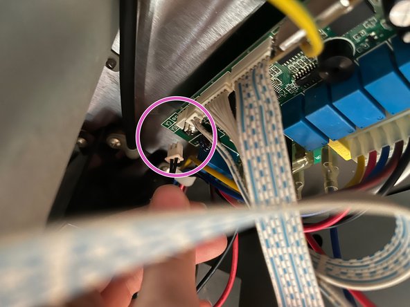

    • To ensure that the hood will never turn on of its own accord again, we can disable the temperate sensor and operate the hood manually only.

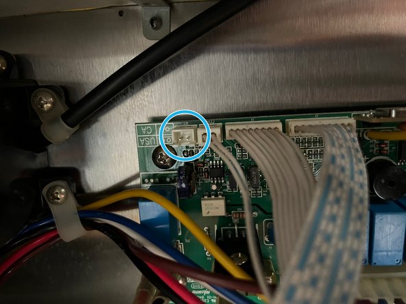

    • Follow the black sensor wire (circled in red) up to the logic board (circled in green) and see where it connects. It is located in the top left and is circled in blue on the second image with the wire removed.
    • The wire has a white connector that plugs into a white socket. Use your nails to pull the connector out of the socket. Wrap this connector somewhere out of the way.
    • On some models removing the sensor makes an error code always show on the display. The hood will still operate normally it will just display this instead of the time.
    • Be sure to not pry the entire socket away with the connector! You should be able to see or feel a gap between the end of the connector and the socket, they are both white and the socket is attached to the board. Pull from the gap using your nail, it does not take much force.

I was ready to buy a new range hood fan because the fan kept going on the turbo speed even if we were not cooking! Luckily, we have it connected to a wall switch and could shut it off. I asked somebody from Broan what the issue could be, and they said the heat sensor. I googled how to install one and I saw your page.
This was so easy to fix and saved me from buying a new fan. The hardest part was reaching over stove to get to the rear screws of pan but otherwise it took me 10 minutes to disconnect that sensor wire and put everything back together.
Thank you so much for your guidance !

Completely perfect solution for our Broan range hood heat sensitive fan issue. Has anyone done any research for getting rid of the error code on the display? I have tried in vain to find a solution to no avail. But, if you press the button with the clock face to the right of the display, you can at least still see your time, etc. Thank you for all this helpful information. Duff
Duff Coburn - crwdns2934203:0crwdne2934203:0
You are quite welcome! Happy it could help solve the issue for you, it is quite a frustrating one to have linger. I have not as of yet had the success of a finding a solution to the error code. For some, it doesn't appear either which makes it more puzzling. Hopefully someone will find it in the future and be able to chime in.
I am intrigued at your suggestion. Are you talking about the rightmost of the two buttons under the display we see in the first image of the guide?
Scout Fox -
The fan on our Broan range hood went on high by itself over an hour after we had used the cooktop. We were not able to turn it off. We found your suggestions and disabled the heat sensor. The error code now is I-L. We have no idea what caused this to happen. We may call Broan and see if they have an explanation? If this is the only fix, we can hid the error code with a little bit of black tape. Thank you for your post on this issue.
