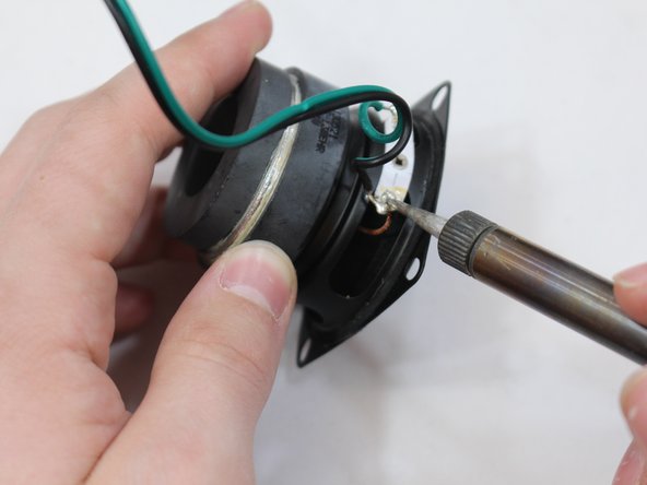

  5. Digitech XC- 5206 Wired Connections Replacement: crwdns2935265:05crwdnd2935265:01crwdnd2935265:02crwdne2935265:0 Digitech XC- 5206 Wired Connections Replacement: crwdns2935265:05crwdnd2935265:02crwdnd2935265:02crwdne2935265:0
    • Remove green (left) and red (right) wired connection to speaker bulb using soldering station.
