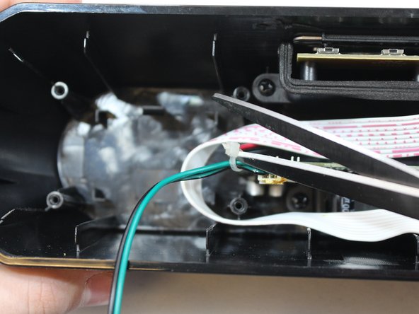

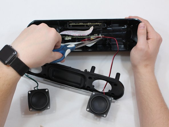

    • Cut zip-ties wrapped around red and green wires using scissors or pliers.

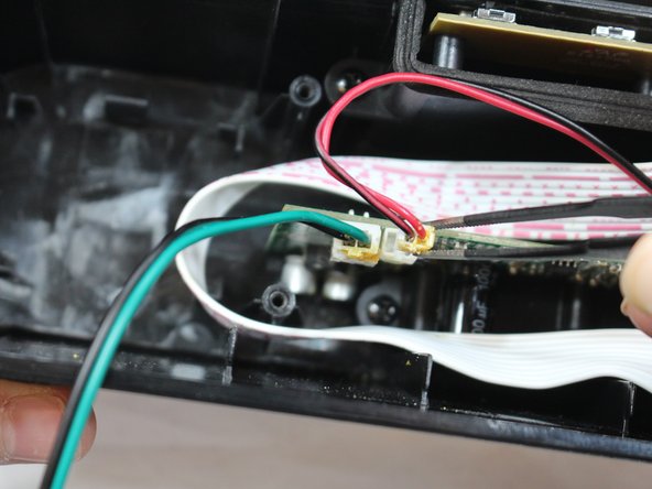

    • Pull wires out of ports using blunt nose tweezers.

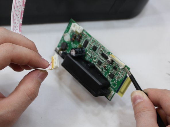

    • Pull motherboard out of slot using the angled tweezers and blunt nose tweezers on each side.
  7. Digitech XC- 5206 Motherboard Replacement: crwdns2935265:07crwdnd2935265:01crwdnd2935265:02crwdne2935265:0 Digitech XC- 5206 Motherboard Replacement: crwdns2935265:07crwdnd2935265:02crwdnd2935265:02crwdne2935265:0
    • Remove motherboard from white wire strip by pulling the two apart using blunt nose tweezers on one side and fingers on wire strip plug.
