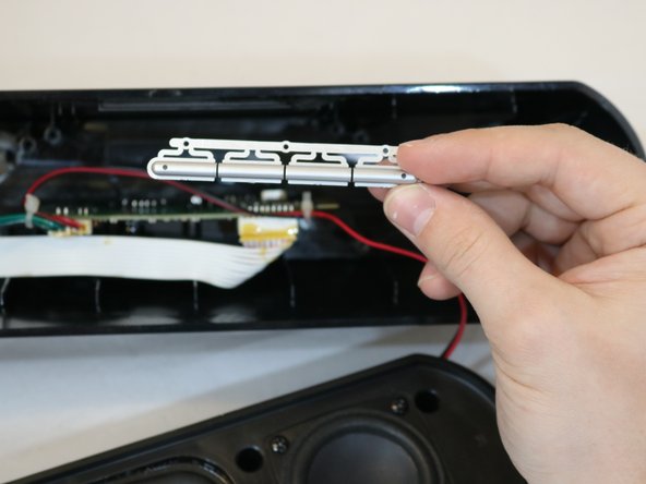

  3. Digitech XC- 5206 Buttons Replacement: crwdns2935265:03crwdnd2935265:01crwdnd2935265:01crwdne2935265:0
    • Unscrew upper panel two 10 mm screws spinning a size PH2 screwdriver in a counterclockwise motion.

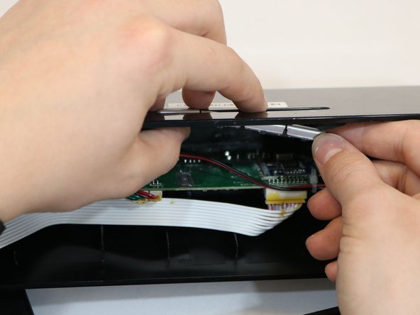

  4. Digitech XC- 5206 Buttons Replacement: crwdns2935265:04crwdnd2935265:01crwdnd2935265:03crwdne2935265:0 Digitech XC- 5206 Buttons Replacement: crwdns2935265:04crwdnd2935265:02crwdnd2935265:03crwdne2935265:0 Digitech XC- 5206 Buttons Replacement: crwdns2935265:04crwdnd2935265:03crwdnd2935265:03crwdne2935265:0
    • Remove circuit board by pulling straight upwards out of slot.
    • Remove plastic buttons by gently pushing buttons from top of speaker and using other hand to pull from bottom.
