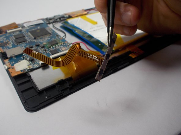

  18. Digital2 Platinum Pad 9 Motherboard Replacement: crwdns2935265:018crwdnd2935265:01crwdnd2935265:02crwdne2935265:0 Digital2 Platinum Pad 9 Motherboard Replacement: crwdns2935265:018crwdnd2935265:02crwdnd2935265:02crwdne2935265:0
    • Then use the precision tweezers to grab the volume buttons.
    • Pull until the buttons come out.

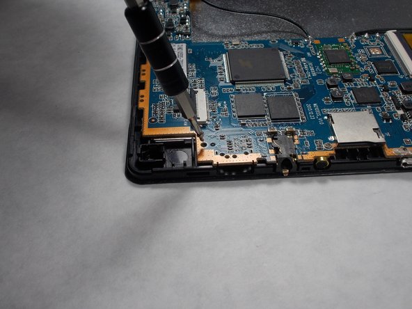

  23. Digital2 Platinum Pad 9 Motherboard Replacement, Motherboard: crwdns2935265:023crwdnd2935265:01crwdnd2935265:02crwdne2935265:0 Digital2 Platinum Pad 9 Motherboard Replacement, Motherboard: crwdns2935265:023crwdnd2935265:02crwdnd2935265:02crwdne2935265:0
    • Use a J0 sized Phillips head screwdriver to remove the three 3.175mm long Phillips head screws from the motherboard.

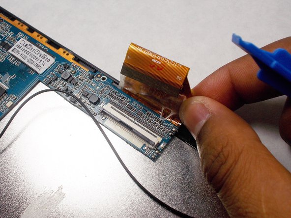

  24. Digital2 Platinum Pad 9 Motherboard Replacement: crwdns2935265:024crwdnd2935265:01crwdnd2935265:02crwdne2935265:0 Digital2 Platinum Pad 9 Motherboard Replacement: crwdns2935265:024crwdnd2935265:02crwdnd2935265:02crwdne2935265:0
    • Insert the plastic opening tool to pop up the ZIF connector holding the ribbon cable down.
    • Remove the ribbon cable.
  25. Digital2 Platinum Pad 9 Motherboard Replacement: crwdns2935265:025crwdnd2935265:01crwdnd2935265:01crwdne2935265:0
    • Remove the ribbon cable from the ZIF connector, it is next to the volume buttons.
