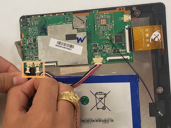

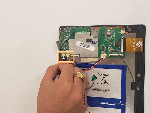

  4. Digiland 10.1'' DL1016 Speakers Replacement, Digiland 10.1'' DL1016 Remove Battery: crwdns2935265:04crwdnd2935265:01crwdnd2935265:02crwdne2935265:0 Digiland 10.1'' DL1016 Speakers Replacement, Digiland 10.1'' DL1016 Remove Battery: crwdns2935265:04crwdnd2935265:02crwdnd2935265:02crwdne2935265:0
    • Use an ESD safe pryer to lift the battery up.
    • There is glue that holds the battery down, so carefully pry it open. You may need to use some force.
  5. Digiland 10.1'' DL1016 Speakers Replacement, Speakers: crwdns2935265:05crwdnd2935265:01crwdnd2935265:03crwdne2935265:0 Digiland 10.1'' DL1016 Speakers Replacement, Speakers: crwdns2935265:05crwdnd2935265:02crwdnd2935265:03crwdne2935265:0 Digiland 10.1'' DL1016 Speakers Replacement, Speakers: crwdns2935265:05crwdnd2935265:03crwdnd2935265:03crwdne2935265:0
    • The speakers are marked in red.
    • Disconnect the speaker connections.
    • Remove the speakers.
