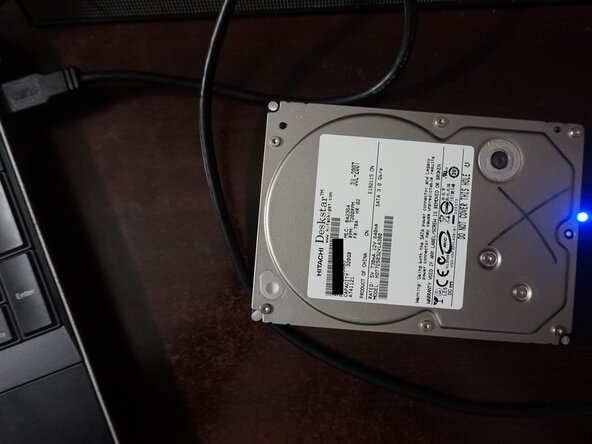

    • Connect the drive internally to your PC (SATA port or secondary M.2 slot), or to a USB drive adapter.
    • If the hard drive is not installed and you do not have a USB adapter, it can be plugged into a motherboard.
