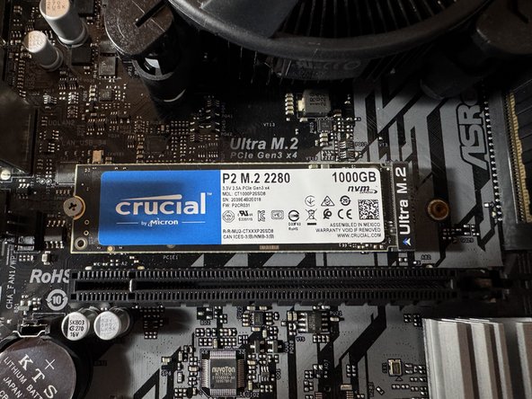

    • This guide assumes the boot drive has been created beforehand. If you need instructions on how to make a bootable USB, Refer to this guide.
    • If you are testing an M.2 SSD (AHCI or NVMe), you will need an enclosure specially built for this. This is not shown in this guide as M.2 was not as prevalent when I wrote this guide.
    • Connect the drive internally to your PC (SATA port or secondary M.2 slot), or to a USB drive adapter.
    • If the hard drive is not installed and you do not have a USB adapter, it can be plugged into a motherboard.

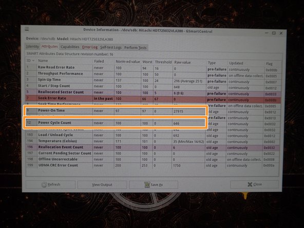

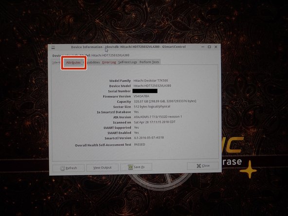

  4. Diagnosing and Erasing Hard Drives, Parted Magic - POH/POC check: crwdns2935265:04crwdnd2935265:01crwdnd2935265:03crwdne2935265:0 Diagnosing and Erasing Hard Drives, Parted Magic - POH/POC check: crwdns2935265:04crwdnd2935265:02crwdnd2935265:03crwdne2935265:0 Diagnosing and Erasing Hard Drives, Parted Magic - POH/POC check: crwdns2935265:04crwdnd2935265:03crwdnd2935265:03crwdne2935265:0
    • While high hours are not an indication of failure, the odds of a failure are much higher.
    • Select Disks from the desktop to open GSmartControl.
    • Select the hard disk you want to test. Click Attributes to read the SMART data.
    • Locate the following attributes: Power On Time and Power Cycle Count.

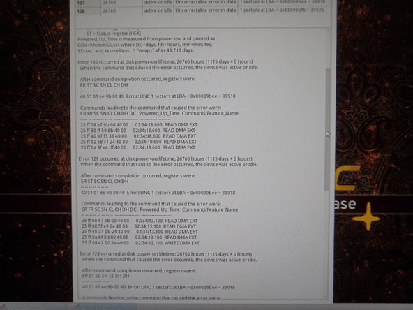

  6. Diagnosing and Erasing Hard Drives, Parted Magic - Error log check: crwdns2935265:06crwdnd2935265:01crwdnd2935265:03crwdne2935265:0 Diagnosing and Erasing Hard Drives, Parted Magic - Error log check: crwdns2935265:06crwdnd2935265:02crwdnd2935265:03crwdne2935265:0 Diagnosing and Erasing Hard Drives, Parted Magic - Error log check: crwdns2935265:06crwdnd2935265:03crwdnd2935265:03crwdne2935265:0
    • Use the error log and SMART data together to diagnose drive problems.
    • Check the error log for drive errors. Click the Error log tab, and review the logs.
    • In the Error log, review the available errors. Read these logs if any are found.

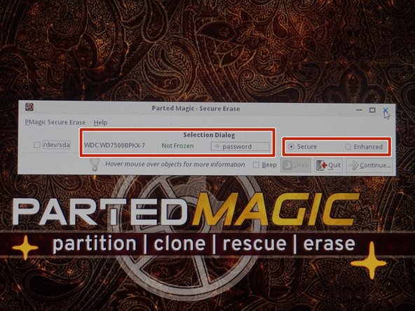

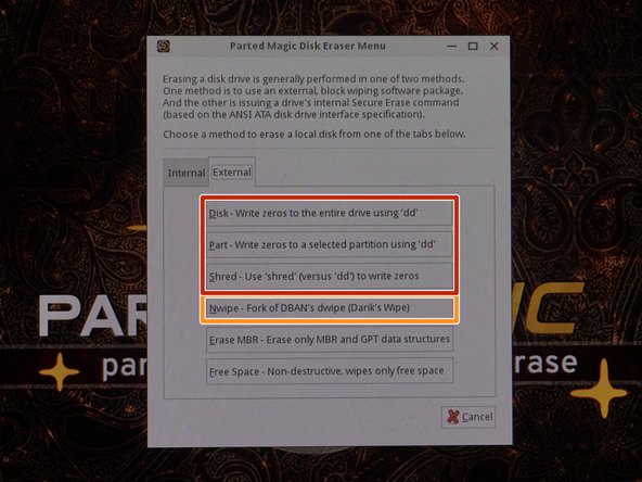

  7. Diagnosing and Erasing Hard Drives, Parted Magic - Erasing hard drives: crwdns2935265:07crwdnd2935265:01crwdnd2935265:03crwdne2935265:0 Diagnosing and Erasing Hard Drives, Parted Magic - Erasing hard drives: crwdns2935265:07crwdnd2935265:02crwdnd2935265:03crwdne2935265:0 Diagnosing and Erasing Hard Drives, Parted Magic - Erasing hard drives: crwdns2935265:07crwdnd2935265:03crwdnd2935265:03crwdne2935265:0
    • When possible, avoid using "sector wipe" on SSDs. This will eat into the TBW of the drive, which can cause problems on older 75TBW drives.
    • The options available here that will work will vary based on what is supported by the firmware on the drive.
    • CAUTION: Drives with known issues in the firmware around the ATA Secure Erase option may be bricked depending on the severity (and risk). If you use this on a drive with known problems, it can potentially brick the drive. When in doubt, select EXTERNAL for safety (at the expense of time/NAND flash wear on SSDs).
    • IF the drive does not support ATA Secure Erase (primarily older drives), you will need to select External and use Nwipe to erase it. The best middle ground in Nwipe/DBAN is "DoD Short (3 pass+blanking).
    • AHCI drives (M.2 SATA/2.5" drives/3.5" drives) When possible for security (and in the case of SSDs, reduced or mitigated drive wear), try to use the ATA Secure Erase option when possible, unless the drive has known bugs (see warning above).
    • NVMe SSD Recomendation: When possible, use NVMe secure erase. This is instant because it destroys the encryption key on these drives so the data can no longer be read and does not need to zero out the entire drive.
