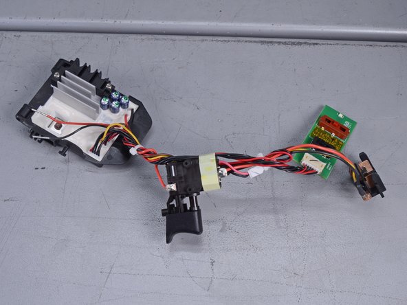

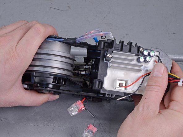

  18. Dewalt Nailers DCN21PL 2018 Main Electronics Replacement, Remove main electronics: crwdns2935265:018crwdnd2935265:01crwdnd2935265:01crwdne2935265:0
    • Use wire snips to cut the small black cable tie securing the four main board wires together.

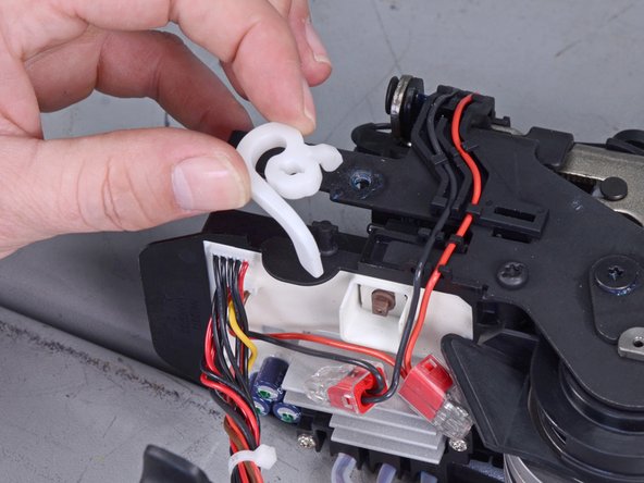

  19. Dewalt Nailers DCN21PL 2018 Main Electronics Replacement: crwdns2935265:019crwdnd2935265:01crwdnd2935265:02crwdne2935265:0 Dewalt Nailers DCN21PL 2018 Main Electronics Replacement: crwdns2935265:019crwdnd2935265:02crwdnd2935265:02crwdne2935265:0
    • Pull the white plastic actuator straight up off its axle to remove.

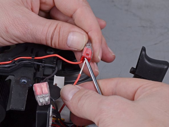

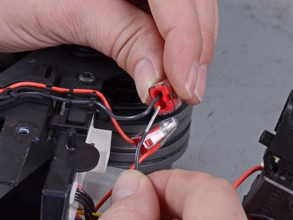

  20. Dewalt Nailers DCN21PL 2018 Main Electronics Replacement: crwdns2935265:020crwdnd2935265:01crwdnd2935265:03crwdne2935265:0 Dewalt Nailers DCN21PL 2018 Main Electronics Replacement: crwdns2935265:020crwdnd2935265:02crwdnd2935265:03crwdne2935265:0 Dewalt Nailers DCN21PL 2018 Main Electronics Replacement: crwdns2935265:020crwdnd2935265:03crwdnd2935265:03crwdne2935265:0
    • Insert the point of a pick tool into the push-in connector's inlet hole, which has the main board wire plugged into it.
    • With the pick tool still inserted, pull the red main board wire out of the push-in connector.
    • Make sure you choose the inlet that connects to the main board, not the solenoid.
    • Repeat this same process for the black wire and other push-in connector.

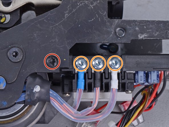

  21. Dewalt Nailers DCN21PL 2018 Main Electronics Replacement: crwdns2935265:021crwdnd2935265:01crwdnd2935265:02crwdne2935265:0 Dewalt Nailers DCN21PL 2018 Main Electronics Replacement: crwdns2935265:021crwdnd2935265:02crwdnd2935265:02crwdne2935265:0
    • Use a T20 driver to remove the following screws:
    • Two 15 mm-long board retaining screws, one on either side.
    • Three 10 mm-long motor wire screws.

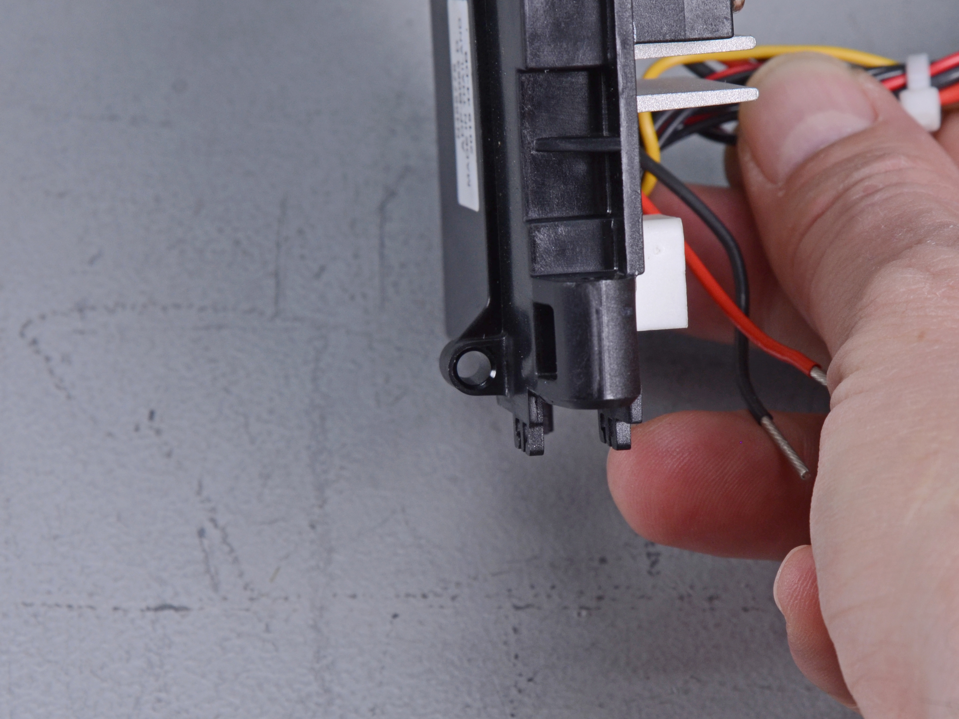

  22. Dewalt Nailers DCN21PL 2018 Main Electronics Replacement: crwdns2935265:022crwdnd2935265:01crwdnd2935265:03crwdne2935265:0 Dewalt Nailers DCN21PL 2018 Main Electronics Replacement: crwdns2935265:022crwdnd2935265:02crwdnd2935265:03crwdne2935265:0 Dewalt Nailers DCN21PL 2018 Main Electronics Replacement: crwdns2935265:022crwdnd2935265:03crwdnd2935265:03crwdne2935265:0
    • Slide the board off its guide pin to remove.
    • Reassembly tip: make sure the actuator plunger lines up with the guide hole on the main board housing.
