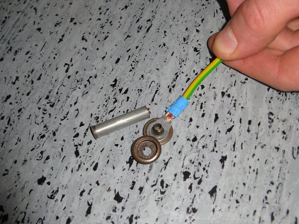

  2. Desk Grounding A Work Bench, Clamping The Clip: crwdns2935265:02crwdnd2935265:01crwdnd2935265:03crwdne2935265:0 Desk Grounding A Work Bench, Clamping The Clip: crwdns2935265:02crwdnd2935265:02crwdnd2935265:03crwdne2935265:0 Desk Grounding A Work Bench, Clamping The Clip: crwdns2935265:02crwdnd2935265:03crwdnd2935265:03crwdne2935265:0
    • A hole is punched in the middle of the table cover.
    • The clip is pressed with a button.
    • A hole is punched in the left edge of the shelf cover.
    • The button and shelves are clamped with clamps.
    • Check with your fingers that the clip does not rotate around its axis. If it rotates, it must be replaced with a new one.

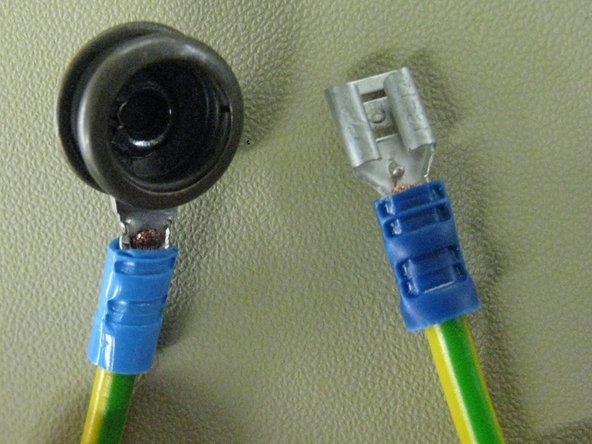

  3. Desk Grounding A Work Bench, Preparation of Wires and Fittings: crwdns2935265:03crwdnd2935265:01crwdnd2935265:03crwdne2935265:0 Desk Grounding A Work Bench, Preparation of Wires and Fittings: crwdns2935265:03crwdnd2935265:02crwdnd2935265:03crwdne2935265:0 Desk Grounding A Work Bench, Preparation of Wires and Fittings: crwdns2935265:03crwdnd2935265:03crwdnd2935265:03crwdne2935265:0
    • Cut a 30 cm long cord (for a table).
    • Cut cable 1.3 m long cable (shelves).
    • The wire is insulated at both ends. Setting the insulation pliers at the 10 mm mark.
    • A quick-connect contact is clamped to one end of the cord.
    • The loop contact is pressed onto the other end and a pin with a hammer is hammered onto it.
    • Only the red pliers mark is used to clamp the contact.
    • Check with your fingers that the head clip does not rotate around its axis. If it rotates, the clamp must be replaced with a new one.
    • For both wires, one end is terminated with a quick-connect contact, the other end with a pin with a head.
