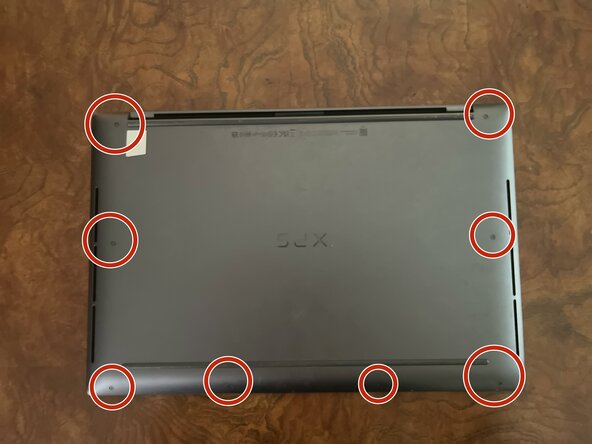

    • The first step is to locate the screws holding the back cover in place.
    • The red circles in the image highlights what the the screws look like, and where they are.

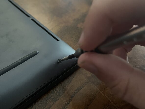

    • Use the torx screwdriver to remove each 3.0mm torx screw.
    • You will know when this step is fully complete when you have unscrewed a total of 8 3.0mm torex screws.
    • Be sure to place the screws together and in a safe location.

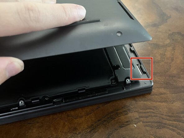

    • Now, pop open the back cover. The cover is attached to the body of the computer by several clips located around the perimeter of the computer, which is shown in the picture by the red square.
    • You should be able to use only your fingers to lift the lid, but in the case where you are unable to remove it, I recommend using a plastic pry tool to gently pry it open. This is done by wedging the tool under the cover and slowly pushing down until the clip comes undone. Do this to each clip until it comes off.

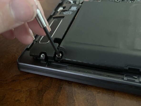

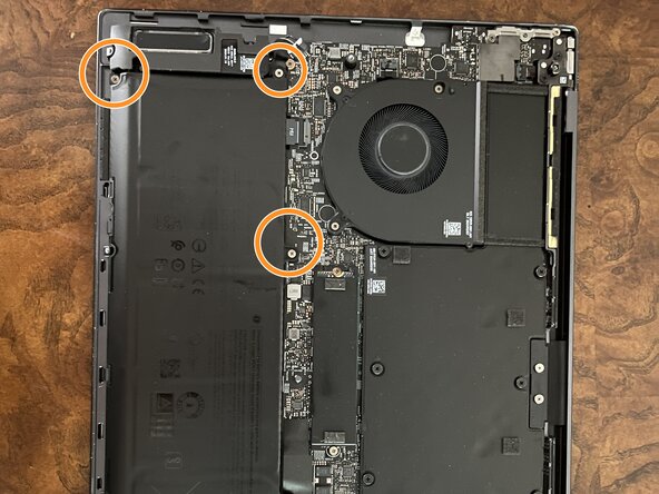

    • The battery is labeled. After locating the battery, identify the key parts of the battery.
    • The first part is where the battery is connected to the computer. This is highlighted in red.
    • The second is the screws that holds the battery in place. This is shown in blue.
    • This step requires a Phillips #00 head screwdriver. Just as before, work around the battery and unscrew each 3.0mm phillips #00 screw. There should be a total of 6. Once again, store in a safe location
    • Be careful not to accidentally damage any components during this step and the next. This is avoided by not touching anything and being aware of where you use your tool.

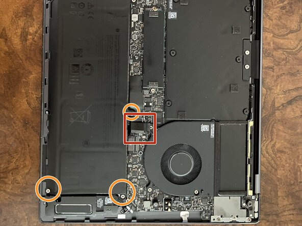

  4. Dell XPS 16 9640 Battery Replacement: crwdns2935265:04crwdnd2935265:01crwdnd2935265:01crwdne2935265:0
    • The final step in removing the battery is to unclip the point where the battery is plugged into the computer.
    • To do this, gently pull up the ring of film and hold on to it firmly. When ready, pull upwards in a swift and vertical motion to disconnect the battery.
    • You can now gentely pick up the battery
