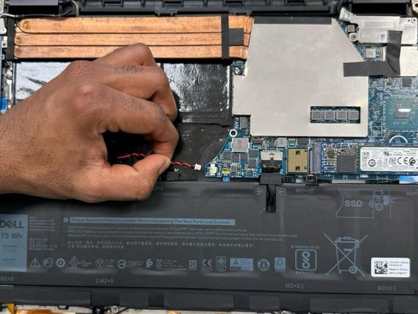

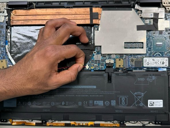

    • Use a spudger to remove the CMOS battery from the board.
    • It is attached with a small amount of adhesive so you may need to pry it off, but be careful not to puncture or bend the battery.
    • Use a spudger to disconnect the CMOS battery connector cable from the motherboard.
    • To disconnect, use the point of a spudger to push on alternating sides of the connector to "walk" it out of its socket.
    • It may take a lot of alternating before the connector comes out. Be patient, and don't pull on the cables.
    • To reconnect the cable, align the connector and use a spudger or clean fingernail to push it fully into the socket.
    • Don't push on the cables themselves, or you may damage the connector.
