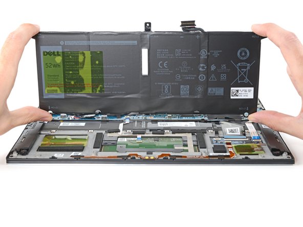

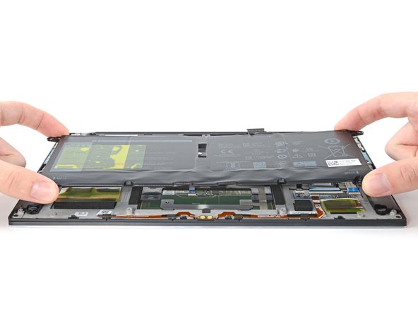

  6. Dell XPS 13 9305 Battery Replacement, Remove the battery: crwdns2935265:06crwdnd2935265:01crwdnd2935265:03crwdne2935265:0 Dell XPS 13 9305 Battery Replacement, Remove the battery: crwdns2935265:06crwdnd2935265:02crwdnd2935265:03crwdne2935265:0 Dell XPS 13 9305 Battery Replacement, Remove the battery: crwdns2935265:06crwdnd2935265:03crwdnd2935265:03crwdne2935265:0
    • Lift the battery straight out of its recess and remove it.
For optimal performance, calibrate your newly installed battery after completing this guide.
