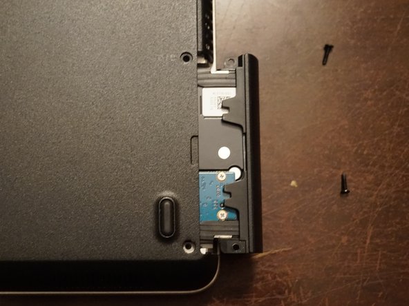

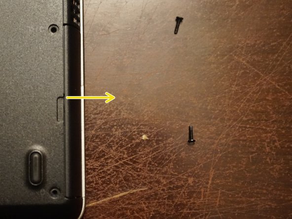

  7. Dell Latitude E6540 Hard Drive Replacement, Remove the chassis screws: crwdns2935265:07crwdnd2935265:01crwdnd2935265:03crwdne2935265:0 Dell Latitude E6540 Hard Drive Replacement, Remove the chassis screws: crwdns2935265:07crwdnd2935265:02crwdnd2935265:03crwdne2935265:0 Dell Latitude E6540 Hard Drive Replacement, Remove the chassis screws: crwdns2935265:07crwdnd2935265:03crwdnd2935265:03crwdne2935265:0
    • EET owners: Your kit has this bit. No purchase needed.
    • The screw marked in orange is directly screwed into the chassis. This point WILL break if overtightended.
    • To remove the hard drive from the computer, remove the two screws. Use the Phillips #1 bit.
  8. Dell Latitude E6540 Hard Drive Replacement, Remove the drive clip: crwdns2935265:08crwdnd2935265:01crwdnd2935265:03crwdne2935265:0 Dell Latitude E6540 Hard Drive Replacement, Remove the drive clip: crwdns2935265:08crwdnd2935265:02crwdnd2935265:03crwdne2935265:0 Dell Latitude E6540 Hard Drive Replacement, Remove the drive clip: crwdns2935265:08crwdnd2935265:03crwdnd2935265:03crwdne2935265:0
    • This step is not required if you are moving the drive to an identical Dell computer.
    • To remove the drive clip, remove the Phillips #0 screw holding the hard drive to the clip.
    • Once the screw is removed, remove the drive starting from the side with the screw.
    • Remove the drive from the right side by removing the drive from the alignment pin.
  9. Dell Latitude E6540 Hard Drive Replacement, Remove the rubber bumpers: crwdns2935265:09crwdnd2935265:01crwdnd2935265:03crwdne2935265:0 Dell Latitude E6540 Hard Drive Replacement, Remove the rubber bumpers: crwdns2935265:09crwdnd2935265:02crwdnd2935265:03crwdne2935265:0 Dell Latitude E6540 Hard Drive Replacement, Remove the rubber bumpers: crwdns2935265:09crwdnd2935265:03crwdnd2935265:03crwdne2935265:0
    • The bumpers are held on with double sided tape. This does not have to be replaced.
    • Once the drive is removed from the clip, remove the rubber bumpers. Transfer them to your new drive.
