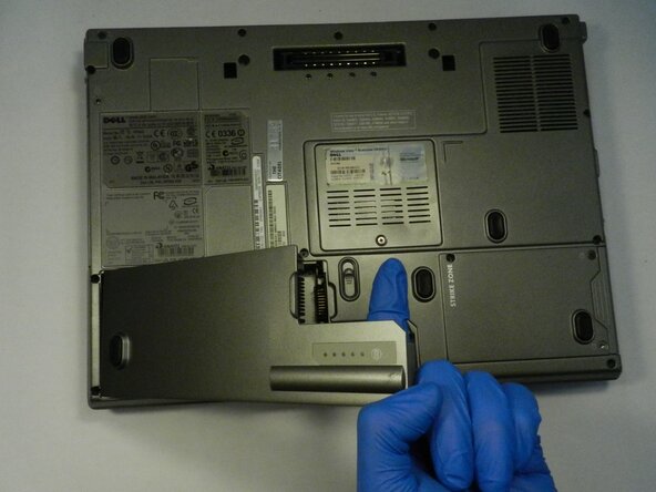

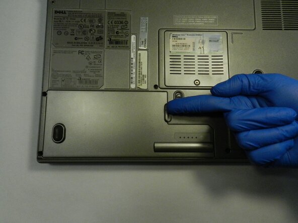

  2. Dell Latitude D830 Battery Replacement: crwdns2935265:02crwdnd2935265:01crwdnd2935265:03crwdne2935265:0 Dell Latitude D830 Battery Replacement: crwdns2935265:02crwdnd2935265:02crwdnd2935265:03crwdne2935265:0 Dell Latitude D830 Battery Replacement: crwdns2935265:02crwdnd2935265:03crwdnd2935265:03crwdne2935265:0
    • Place your finger/ thumb on the slide button, then push the button forward.
    • This unlocks the battery.
    • Place your finger/thumb under the ledge of the battery.
    • Lift the battery and remove it from your laptop.

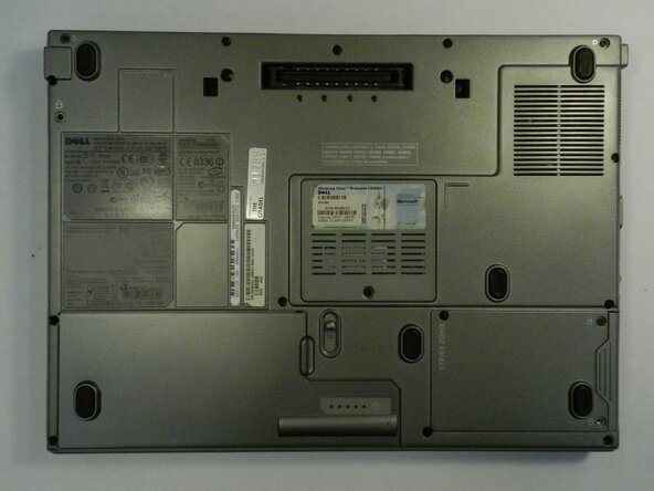

  3. Dell Latitude D830 Battery Replacement: crwdns2935265:03crwdnd2935265:01crwdnd2935265:01crwdne2935265:0
    • The battery is now removed.
To reassemble your device, follow these instructions in reverse order. Take your e-waste to an R2 or e-Stewards certified recycler.
