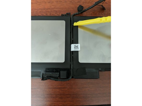

  5. Dell Latitude 7480  Battery Replacement, Install the battery cable: crwdns2935265:05crwdnd2935265:01crwdnd2935265:02crwdne2935265:0 Dell Latitude 7480  Battery Replacement, Install the battery cable: crwdns2935265:05crwdnd2935265:02crwdnd2935265:02crwdne2935265:0
    • Connect the battery cable to the new battery. You can skip this step if your new battery came with one installed.
    • Connect one end of the battery cord to the battery. Route the cord in the channel between battery cells.

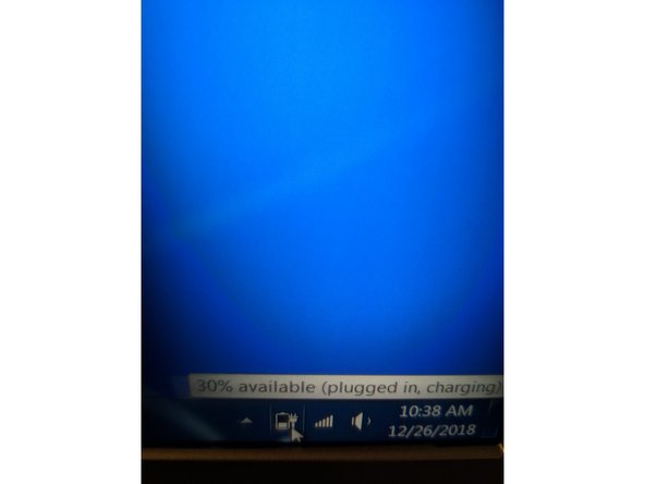

  6. Dell Latitude 7480  Battery Replacement, Install the new battery and test: crwdns2935265:06crwdnd2935265:01crwdnd2935265:02crwdne2935265:0 Dell Latitude 7480  Battery Replacement, Install the new battery and test: crwdns2935265:06crwdnd2935265:02crwdnd2935265:02crwdne2935265:0
    • Install the new battery by doing the steps in reverse. Be sure to test the device with and without AC power applied to the laptop.
    • Dispose of old battery properly and safely.
